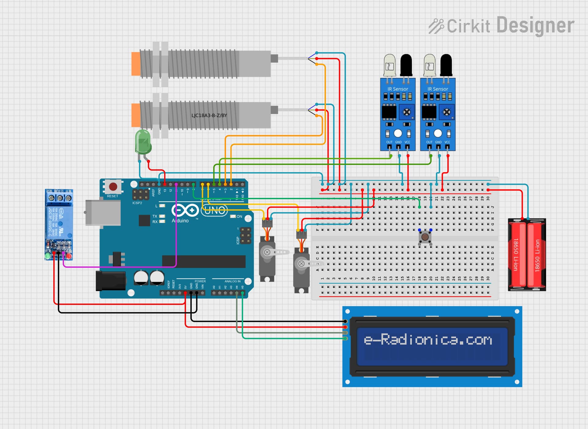

Thoughts of my program
May i know your thoughts on my program, because for me i think on case botready and case charging is kinda messy

The main thought is a question. Does it work the way you want or does it not?
My code complied but i haven't tried testing it with the necessary components because my batteries are out of charge
Why would you run this on a battery instead of the mains with an appropriate power supply?
Have you tried the inputs that are active LOW with INPUT_PULLUP?
You did not verify data sent to the LCD is limited to 16 characters.
Seems like everything is "non-metal".
That tells me your DID NOT TEST during program development! So, I do not think much of your program nor your method of program development. Test and then begin debugging and tell us how the results match your requirements.
That problem is easy to solve.
Not quite correct.
Declaring a variable with an initializer inside a case, without limiting the scope of the variable to that particular case, will cause problems. The scope of the variable is the remainder of the switch statement, so the compiler sees the initializer being skipped for any subsequent case. The practical result of this, with the gcc compiler used by the Arduino IDE, is that no subsequent case can ever be executed.
If the Arduino IDE preferences are set to show all warning during compilation, it will display warnings:

Here's the updated code that I tested(it works). I'd want to hear your opinions on my code, and just a reminder that I'll be recoding the state charging and adding comments about those funtions later on.
Note: I used an Ir-Sensor(active on LOW) as a temporary replacement for the Capacitive Sensor(active on HIGH), because the wires of the Capacitive sensor is messy
bool capActive = !digitalRead(capSensorPin); // Active on HIGH

I used an Ir-Sensor(active on LOW) as a temporary replacement for the Capacitive Sensor(active on HIGH), because the wires of the Capacitive sensor is messy. My inductive is npn and capacitive is pnp and the rest is ir sensor that are active on LOW
What do you mean by that
Alright, I'll reply with a circuit diagram. And what is a truth table and how it works?
I believe i do ensure that the character strings fit on my lcd
The first "material added" does not get a "time added" reaction/response.
Prove it.
This happens to everyone... you write the code... read the code... edit the code... re-write the code.. and so you have been staring at the same code... to the point you do not "see" your code (because you have seen it so many times). You will discover in your programming/job/life that you can miss little parts, but a "second set of eyes" (untrained, unknowing) will immediately spot the anomaly. Don't get too defensive of your code. There will always be someone who finds something.
i see, i've change it now
it does add up i've check it in serial monitor too

That was not what I found, so...
I will wait to verify with your drawing.
i dont get it, can you explain it to me?
btw i want to add minutes seconds like 15:00?
What are the two yellow things?
those are the Inductive(at the top) and Capacitive(at the bottom) Proximity Sensors
From the picture in post #16 it looks like you are using a Uno. You have a lot of string constants such as in Serial.println("State Prompt - Trash Bin Emptied"); which tend to fill the RAM. What does the compiler output tell you about the usage of storage?
this
