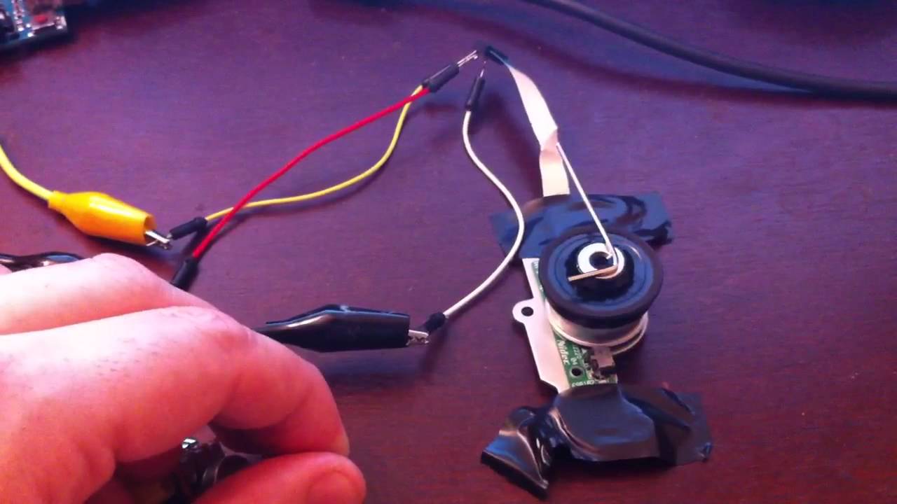

I found a Brushless DC motor off of a CD drive and ran it with this Arduino. It makes a much more interesting demonstration for most people since this type of motor is difficult to work with. Still, the added complexity of my inverter means that anyone seriously planning to control brushless motors should purchase an electronic speed controller https://store.diydrones.com/ArduCopter_ESC_20_Amp_p/ac-0004-08.htm. Still, using the Arduino directly does make a good way to learn how these operate.
Here is my youtube video of the cd motor running:
Here is the code being ran in the video:

I switched to using switch case instead of a lot of if statements which rather mysteriously allowed the motor to spin the motor at a notably higher speed. Unfortunately the speed control programming makes it run a little choppy. The Arduino seems to need to stop and think at regular intervals.
This code, without the speed control, runs faster. I can get a wavelength as short as 15ms to work, which means that the motor is spinning something around 1800 rpm.
