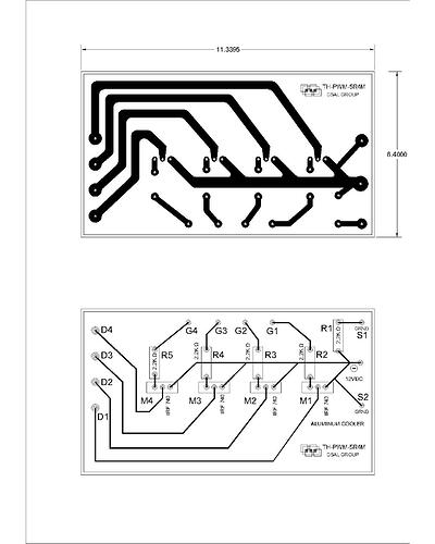

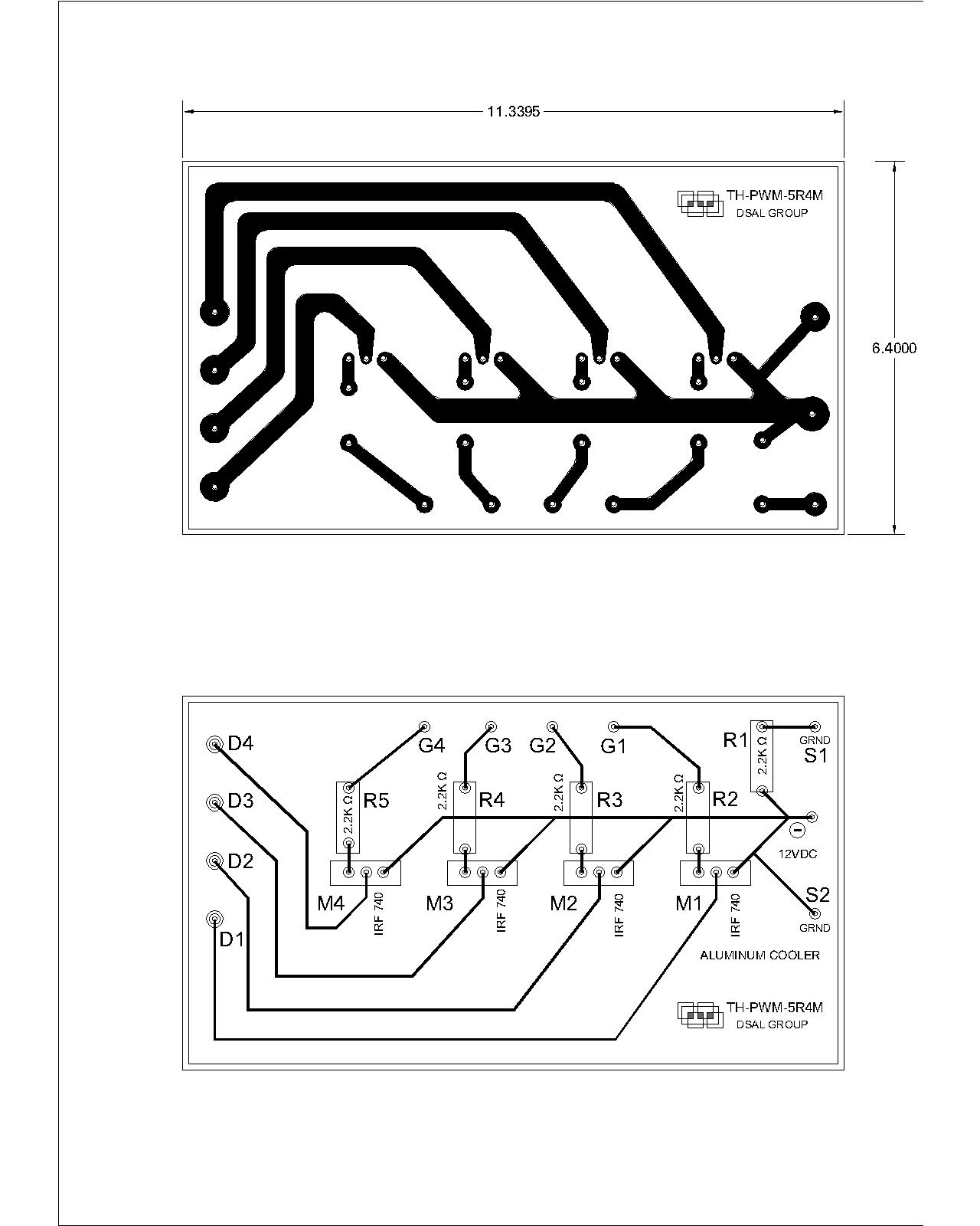

Loads of work ( my Architecture practice) and finally i got free on this Sunday to work on my Thermistor Controlled PWM project for 12 VDC I am calling it " TCP-01" , so produced a pcb using this drawing for the above concept. this drawing i produced on AUTOCAD which i use for my Archi projects.
Hope you get an idea. PCB is ready with etching and all components installed. I am about to test it real time, may take a few days, because i am going to be busy again.
pcb circuit pwm hho.pdf (65.8 KB)

What does R1 do?
What is S1 and S2?
Can you please post a copy of your complete circuit, in CAD or a picture of a hand drawn circuit in jpg, png?
Showing all your connections and labels.
If you can do PCB layout, you can do a decent schematic...
Thanks.. Tom.. :slight_smile:
Isn't it wonderful how all our good advice is completely ignored?
No flyback diodes. No pull-down resistors on the gate. Still an improper MOSFET. No obvious space for a 60W heat sink.

R1, R2, R3, R4, R5 is for controlled voltage of signal to MSFET ( safety for arduino)
G1 and G2 is analogue singal coming from Thermistor
( 5v----thermistor(10K)----A0----resistor(10K)---GND) typical Signal A0, or for A1 etc
I am an architect and it is the progress i made in just 4 days of learning and experience, So, dont expect a master piece yet. S1 is for GND signal for Arduino and S2 is i kept to measure Voltage / Amperage etc for future
