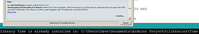

I'm using IDE vers. 1.8.19, perhaps that's the issue here, but Paul Stoffregen's Time library will not update, it is stuck on 1.5.0.
It says it is installing, but the progress bar at the bottom of Library Manager does not fill, even though it says it is updating the list if installed libraries.
When "finished" it still says I have 1.5.0 installed.
I've just updated a load of other libraries with no issues.
Anyone know what is occurring (or not occurring, lol) ?
This Timelib.h : ?
It doesn't matter which updated version I try to update to, or even install, I'm always left on 1.5.0.
Obviously I don't have the 1.5.0 listed on my Select Version drop-down, because that is the version I already have installed.
I thought the "Update" button on the right always updated you to the latest version ???

Here's what I get, before AND after updating ...
2023-12-13_125649
and whether I choose "Install" (latest version), or just "Update", the IDE just keeps telling me that Time is already installed ...
It is here:
I have deleted time.h, restarted the IDE, and it still says 1.5.0 is installed.
How do I get rid of it to install fresh ?

Yes I suspect that's what may have occurred, but I have now got this library updated.
I deleted the Time folder in my Libraries, then restarted the IDE.
Libraries Manager still said I had 1.5.0 Installed, but I clicked on "Update" and it has updated successfully to 1.6.1.
