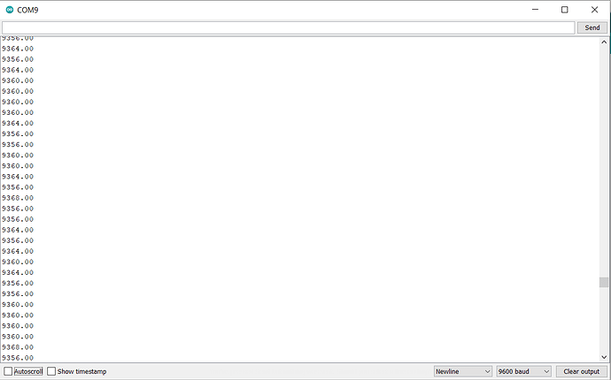

Time measurement issue when using SPI protocol
Hi, I'm trying to use potentiometer to measure angle and differentiate it to angular velocity. I can easily do it by using micros to measure time at each point but the result is look strange when I'm using SPI communication in the same file. How does the large value occur? and How can I solve this?

I'm not sure. This is my code if you want to see. Many lines are not related to this issue but it is in my project.

How do you measure and calculate the time difference?
(code example)
Is it in micro-seconds or milli-seconds?
I suggest to think about if the time value, e.g. a tick value, rolls-over.
You get a value for start which is almost before a roll-over. After the call the end time is after it has rolled over. If you substract now as end minus start - it is too large (a small value minus a large value gives you a negative value but taken as unsigned it will be a large value).
Which Arduino are you using?
Which pot are you using?
How have you wired it up?
How big is the angular velocity are you expecting to measure?
Including timer interrupts?
I use micro-seconds as above code and you're right. The large number actually is negative number but I use unsigned long. However, I found that negative number occur because 'nointerrupt' according to [TheMemberFormerlyKnownAsAWOL] reply.
You're completely collect. This is the problem line and after remove this line, time difference looks good.
Thanks for your attention. I removed 'nointerrupt' line and every thing look good.
