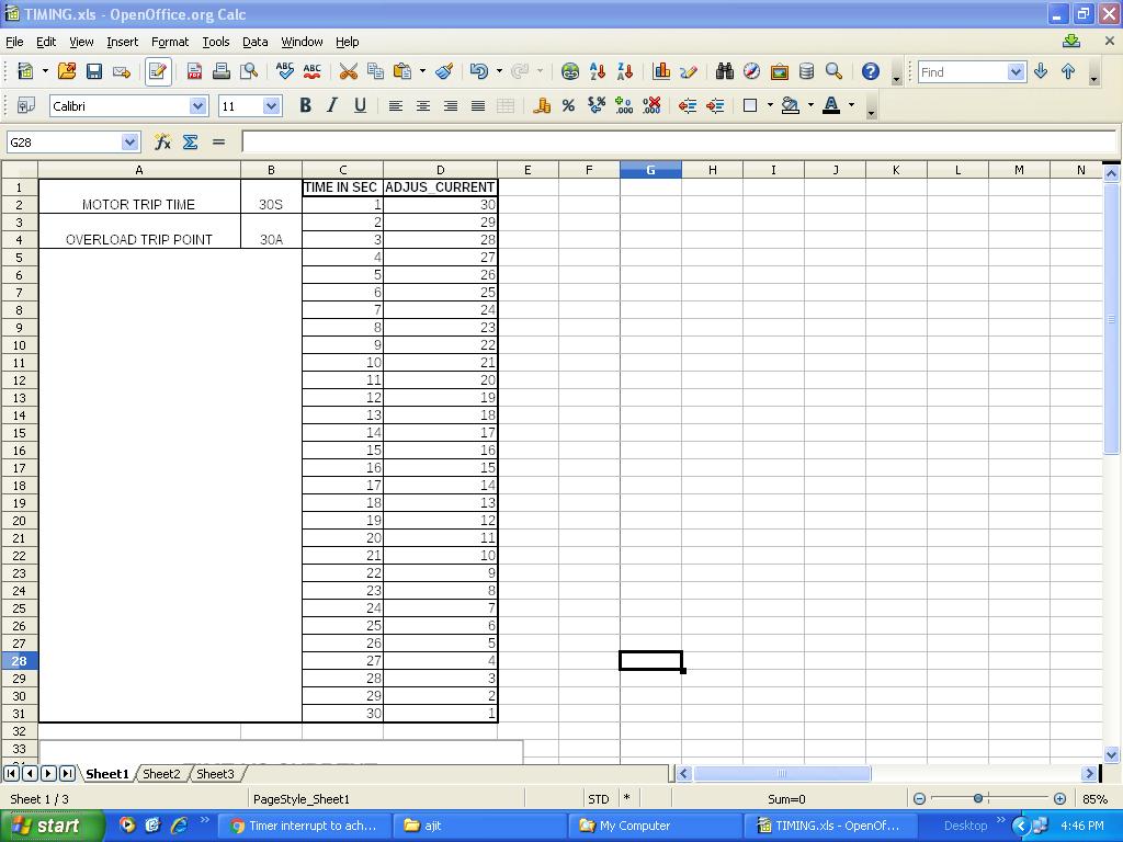

Dear all ,
I wanted to implement with arduino uno
I need simple favor implementing this code in timer interrupt.
I have pdf attached for reference.
I have overload trip of motor setting 30A with Trip Time 30S as example . i would like to achieve attached curve using timer interrupt. can someone guide me how it can be implemented.
user can change over loadtrip and timing accordingly.
curve is meant to achieve below function
Lower current higher trip time and higher current lower trip time
TIMING.pdf (17.9 KB)

Sorry i missed some part. Actually i need to take percentage of overload set current.
In example overload trip time is 30s and overload_trip_current is 30A
while getting trip (overload_trip_current *30%)+overload_trip_current
in chart ,
if actual nominal current is % value of overload_trip_current corresponding trip time to be selected. Let me know how it can be achieved in code with timer interrupt

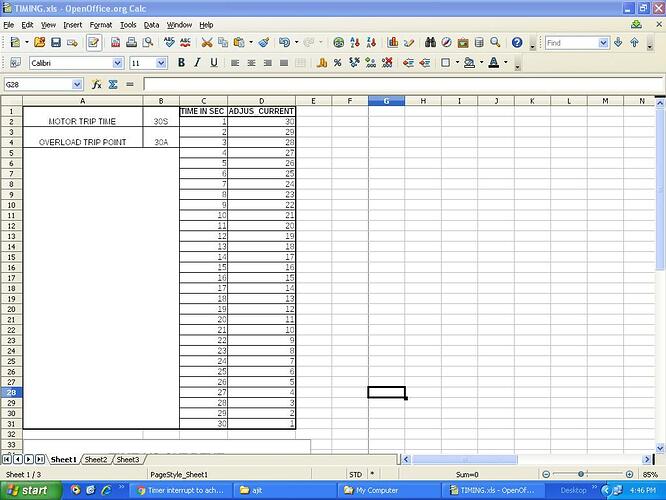

img1.JPG is just a screen capture of the spreadsheet shown in TIMING.pdf.
Your chart and your graph don't agree. The time scale is reversed in the graph.
In what universe does it make sense for a motor capable of drawing up to 30A to get shut down after 30 seconds at 1 Amp? If you extend the graph for another second and another Amp you will have the motor shutting down in 31 seconds if it doesn't draw any current at all.
It looks like you don't understand the design requirements. Perhaps the motor can stand 30A indefinitely but 100% overcurrent (60A) trips immediately and 50% overcurrent (45A) trips in 15 seconds (half the 30-second range). That would have 33A (10% overcurrent) tripping in about 27 seconds (10% under the 30-second limit).
Please refer image carefully.
Those are set value not the trip value.
i given sample example.
overload current limit 30A
In next column i have drive time vs adjustment of curve.
where 30A current takes 1s to trip time and 1A current takes 30S
actual data pdf not updated.
actually its wrong in method . correct method as below
if nominal current > ((overload_trip_current_limit *30%)+overload_trip_current_lmit ) then trip time should be low
if nominal current > ((overload_trip_current_limit *1%)+overload_trip_current_limit ) then trip time should be high
i wanted to achieve this in timer interrupt .
