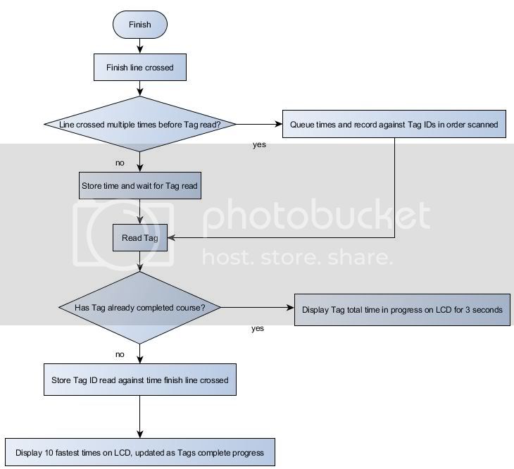

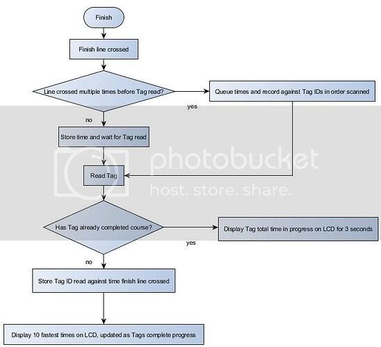

Hi All,
I am using the following hardware,
Arduino Mega 2560
ITBD02 moudule
3.2" TFT touchscreen module
ID-12 RFID reader x 2 (The ID-12's are connected to serial 2 & 3)
Momentary switch x 2 (The switches are connected to pins 8 & 9)
Lets say I have an RFID reader and switch at the 'start' and the the same at the 'end'.
What I would like to be able to do is scan an RFID tag at the start and then activate a switch which logs the time interval the switch was activated against that specific tag.
At the end the reverse would happen, a switch would be activated and time logged then the system would wait for an RFID tag to be scanned which will then be associated with the time just logged.
Once an RFID tag has gone through both start and end procedure I would like the time taken to be displayed on the TFT screen in minute/second/milisecond format.
This is the code I have so far, all it does is prove my hardware works, I get time intervals displayed on the screen and RFIDs spat out over serial but im not sure what I need to do next to accomplish my objective.
Any and all feedback and advice much appreciated! Regards Jason.
