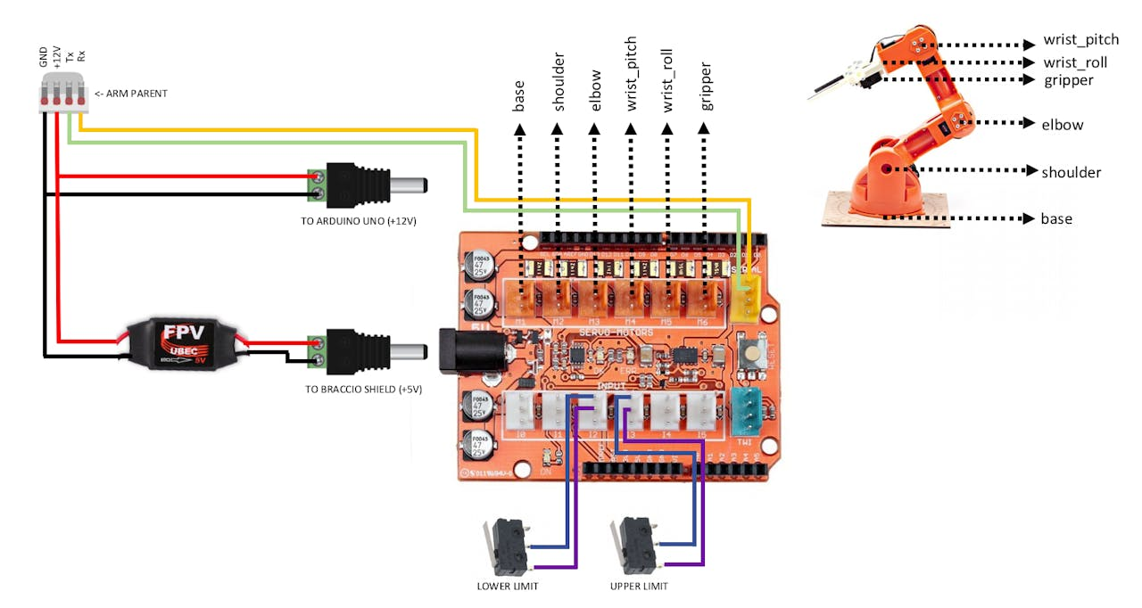

Use 5VDC power for the shield and 7.5 - 12VDC for the Arduino.
I do not have a source for the Braccio Shield. It has input pins (white), servo pins (orange), serial connector (yellow) and I2C connector (green)... as well as power conditioning, communication I.C.s and connections to the Arduino Uno.
You could try running without the shield, using Hardware Serial for communications.

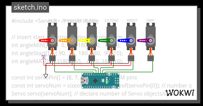

I can connect the +- of the servos directly to the power supply (so the current won't affect the Arduino board), and use the Arduino's PWM pins for control...
The Braccio library won'twork anymore, so it will keep me busy for some time developping a new library!
