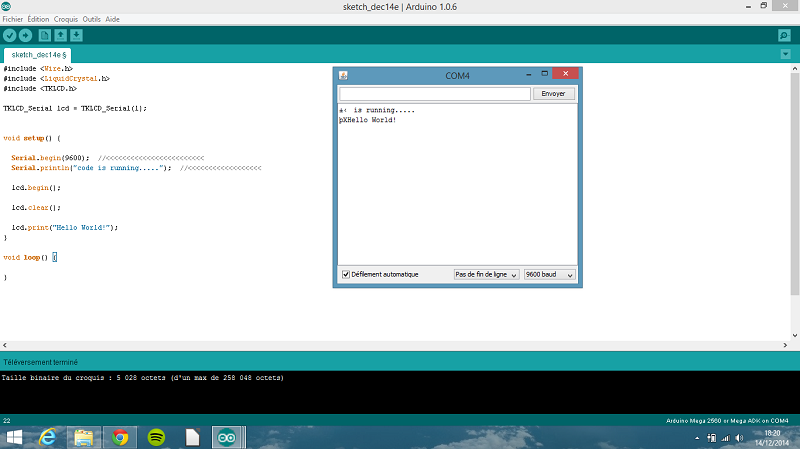

We have the done uploading message and when we open the monitor the message
"±‹•is running.....
þXHello World!" appear.
But nothing was printed on the LCD.
þXHello World!"
Presumably that's what you put in your Serial.print()?
We put just what you said us to put !
"Hello world" is in the function lcd.print and "code is running....." in serial.printIn.
Some signs appear and there are more and more signs coming and we don't know why, just look at the pictures.

I'm confused a bit: does it display "Hello world" in the monitor, even though you have that in an lcd.print()? If so that's really weird....
Yes !
That's probably because they use the same serial port.
The Mega has many ports, so change the ones I added to Serial2.xxxx
Sorry I hadn't noticed it was a mega.
That should get the monitor prints working correctly I guess.

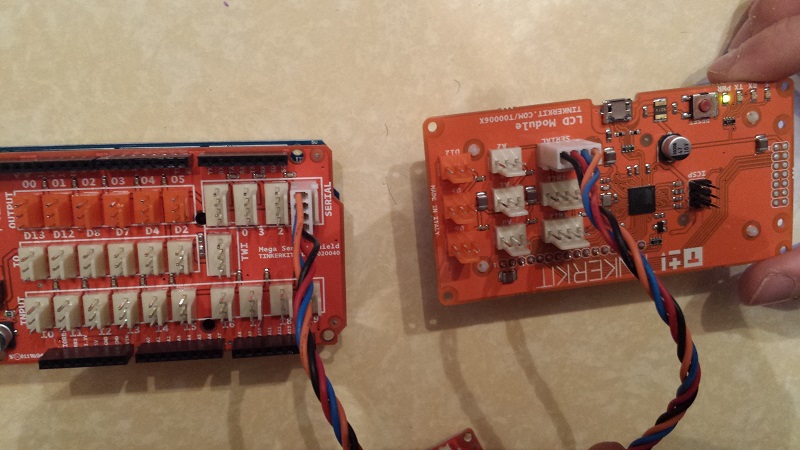

I wonder if the lcd thing is a serial setting problem, stop bits and stuff. See here.
Actually it's easier to change your lcd to a different serial port and change its number
But other than checking the serial parameters for your lcd, I'm out of ideas. You can remove the lines I said to add in fact, since we know the sketch is actually running.

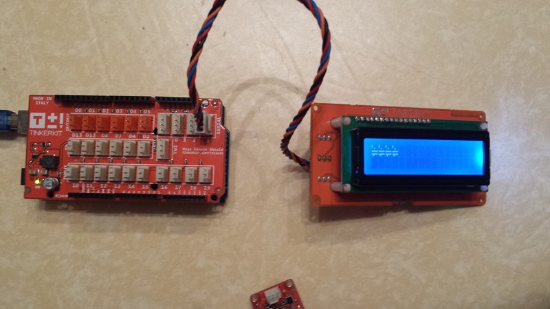

We changed the port on the megashield, now it's actually hook up on serial2. And it appear "code is running..." on the LCD ! ;D
Do lcd.begin ; lcd.print() are useful ?
