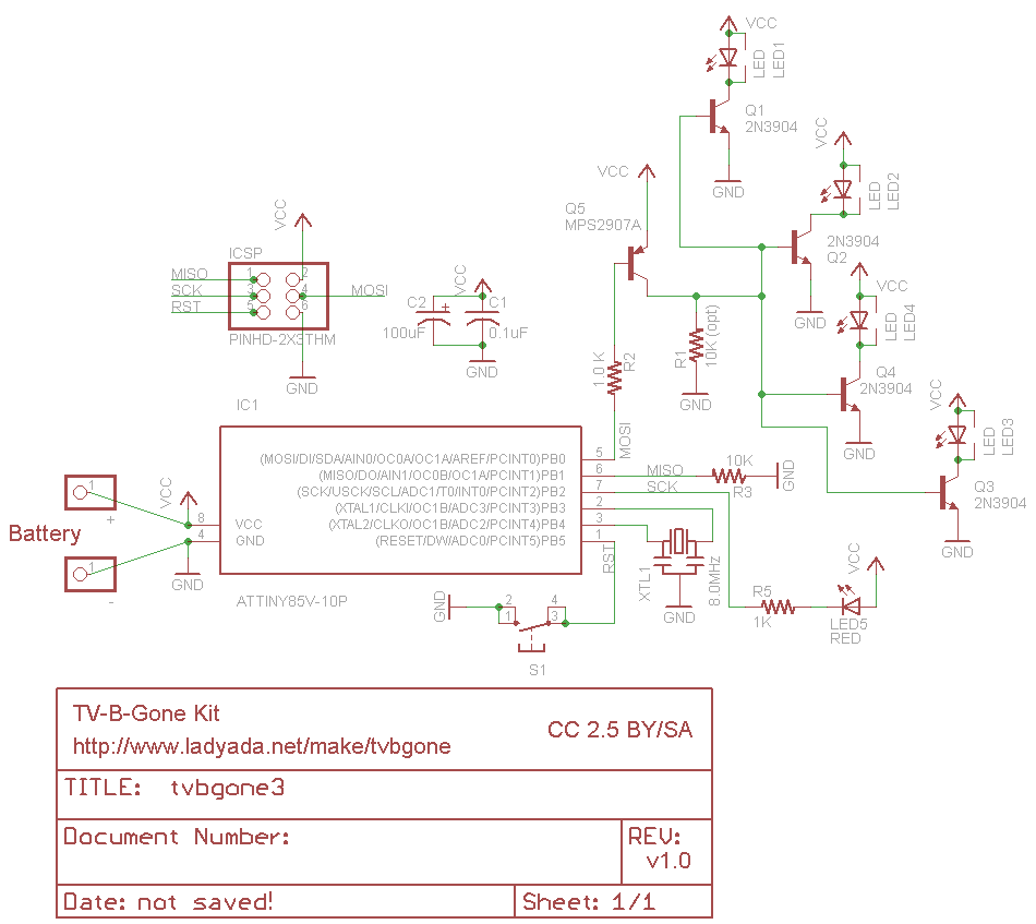

The high power requirement is just for short flickers of the IR LEDs, so most of the time I'd just need power for the Mini.

An arduino-like circuit with some flickering IR LEDs should run OK off of 3 series connected 1.5V button cells (4.5V nominal) without any need to boost to exactly 5V. For example, see the TV-B-Gone circuit from Adafruit.

bircoe, the project is very similar to a TV-B-Gone-- waits for a button press, emits some flashes. I use a pnp resistor to trip four npn resistors, just like the latest Adafruit TV-B-Gone version.
Using three button cells to get to ~4.5V might be the easiest route to completion-- enough for a laser pointer should be plenty for my needs. A smaller lithium like a cr123a sounds good too if I the button cells can't swing it.
