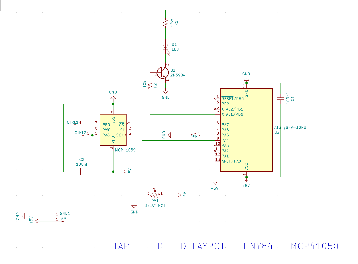

back with a tiny84,
still struggling to get my code to work correctly,
my pot controls the flashing speed of the led correctly, but not the digipot (SPI?)
tap switch doesn't work, it should also change the flashing speed of the led and the digipot
I originally had this working on a 328p, the board I made was messy so I made another with some pin changes,
that didn't work, couldn't figure out why, so I etched another board with the original pin config, still didn't work, same problems as attempt 2, tried again, same problem again, so I ordered another 328p and some crystals, still waiting for them to arrive 4 weeks later, so I tried using the tiny85 (reset pin!)
and now the tiny84
if anyone can see anything wrong with any of this it would be greatly appreciated

You've made good progress, at least part of the project is working.
Your tap switch is probably not working because you're trying to use one of the USI pins as the input, and you can't do that and use the USI module at the same time. Do this to double-check:
  1. Upload a simple sketch that just reads the tap button and turns the LED on or off depending on the state of the tap button.
  2. Modify the sketch to include SPI.h and the SPI.begin() command, see if the LED still works.
The digipot isn't working because you're using the wrong pin. Although it is labelled 'MOSI', the ATTinyCore documentation has this to say:
Take care to note that the USI does not have MISO/MOSI, it has DI/DO; when operating in master mode, DI is MISO, and DO is MOSI.
DO is PA5.
moved tap input to PA3 (pin 10)
and changed the output to the digipot to PA5 (pin 8 - DO)
no change,
tap button still doesn't change the led flashing speed or the digipot
and like before rotary pot only changes the speed of the led

  SPI.begin();
  pinMode (slaveDelayPin, OUTPUT);
  pinMode(ledpin, OUTPUT);

int digitalPotWrite(int pin, int value)
  digitalWrite(pin, LOW);   //When Slave is LOW, the MCP listens to the master
  SPI.transfer(0x11);
  SPI.transfer(value);
  digitalWrite(pin, HIGH);  //When Slave is HIGH, the MCP does not listen to the master
I can't see anything obvious after a quick readthrough of your code. Your best bet would be to write a real simple sketch that just turns the LED on or off depending on the state of the switch. That'll give you an indication as to where the problem lies- either with code or hardware.
