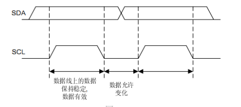

  2. Data stability requirements
When SCL is high, the signal on SDA must remain unchanged; only the clock signal on SCL is low
Only when the signal on SDA can be changed.

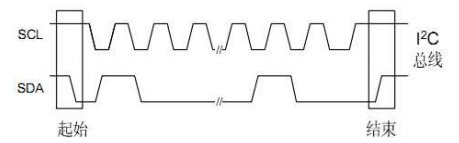

According to the start and end conditions of the transmission
Start condition: when SCL is high, SDA changes from high to low;
End condition: when SCL is high, SDA changes from low to high;

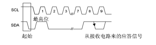

Acknowledgment signal bit (ACK)
When transmitting the response signal, the host control signal pulls the SDA line high through the pull-up resistor; and the addressed chip should
When answering, pull the SDA line directly low and keep it for one bit. After receiving a byte correctly, the chip will send a response
Signal; that is, at the ninth clock pulse, SDA is set to low level; the control part generates an end command to suspend the transmission of data
according to.

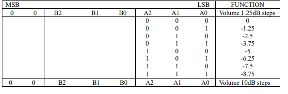

  1. Instructions
Device address:
Control byte format description:
Data control bit detailed description

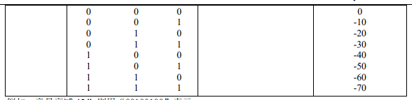

  1. Volume control command:
    For example: the volume attenuation is 45db, it is represented by "00100100".

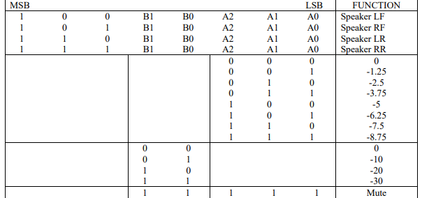

  2. Speaker attenuation command:
    For example: the right channel of the front speaker has an attenuation of 25db, which is represented by "10110100".
  3. Input switch/loudness control/input gain command:
    For example: Choose stereo channel 2 to input a gain of 7.5db, and turn on the loudness, it will be represented by "01001001".
    Note: Stereo4 has no external pins.

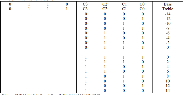

  4. High/bass sound quality control commands:
    For example: if the bass output gain is -10db, it is represented by "01100010".
