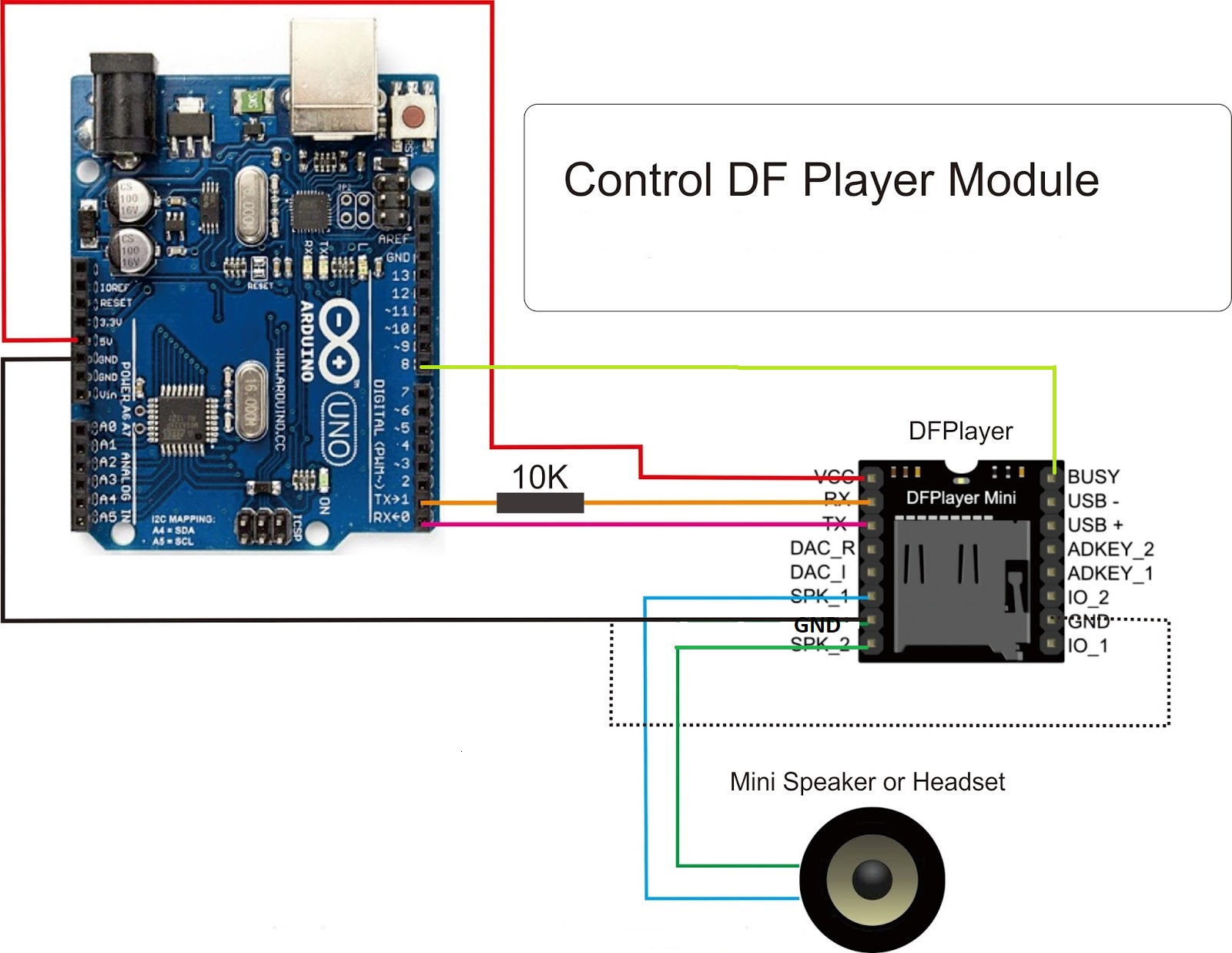

Hello,
If this library does not work properly, and you want to purchase a player module, I would indicate the DFplayer mini, which can play mp3, SD card, and also accepts USB, if you use a USB connector on it.
I am working with a Mega 2560 and bought a W5100 Ethernet Shield with miniSD card slot. I do not wish to buy any more parts if possible. Thank you.
