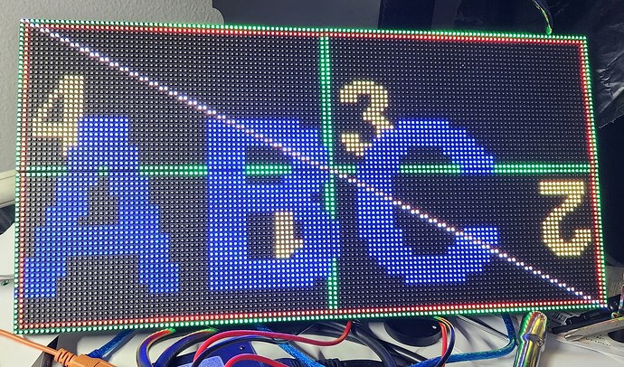

   // draw blue text
   virtualDisp->setFont(&FreeSansBold12pt7b);
   virtualDisp->setTextColor(virtualDisp->color565(0, 0, 255));
   virtualDisp->setTextSize(2);
   virtualDisp->setCursor(0, virtualDisp->height()- ((virtualDisp->height()-45)/2));
   virtualDisp->print("ABCD");
//    Red text inside red rect (2 pix in from edge)
   virtualDisp->drawRect(1,1, virtualDisp->width()-2, virtualDisp->height()-2, virtualDisp->color565(255,0,0));
//    White line from top left to bottom right
   virtualDisp->drawLine(0,0, virtualDisp->width()-1, virtualDisp->height()-1, virtualDisp->color565(255,255,255));
//   virtualDisp->drawDisplayTest(); // re draw text numbering on each screen to check connectivity

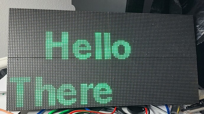

   virtualDisp->setTextColor(virtualDisp->color565(0, 222, 0));
   virtualDisp->setTextSize(1);
   virtualDisp->setCursor(0, virtualDisp->height()- ((virtualDisp->height())/2));
   virtualDisp->print("   Hello      There");
   delay(2000);

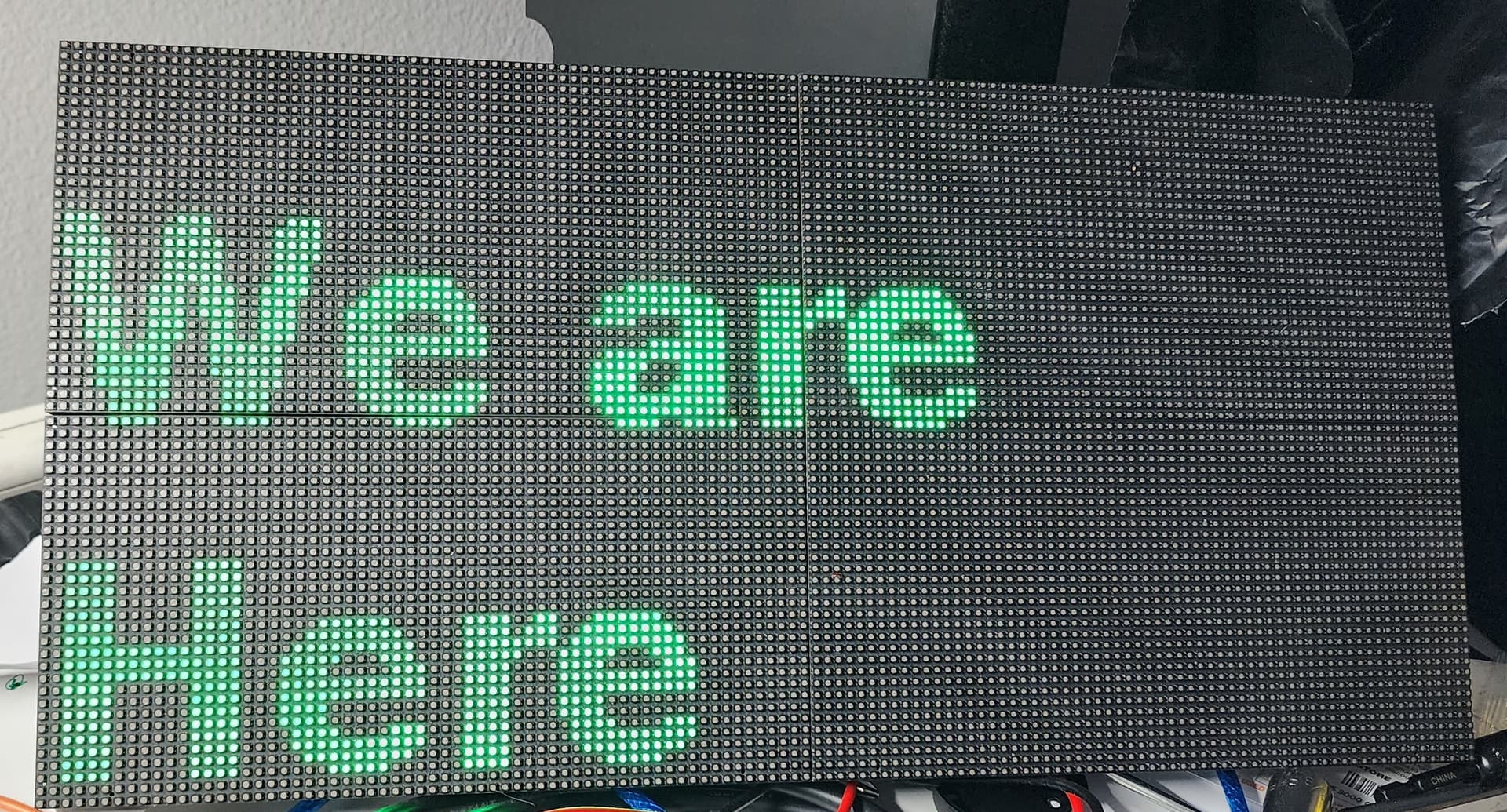

   virtualDisp->print("We are      Here");
   delay(2000);
virtualDisp->fillScreen(virtualDisp->color444(0, 0, 0));

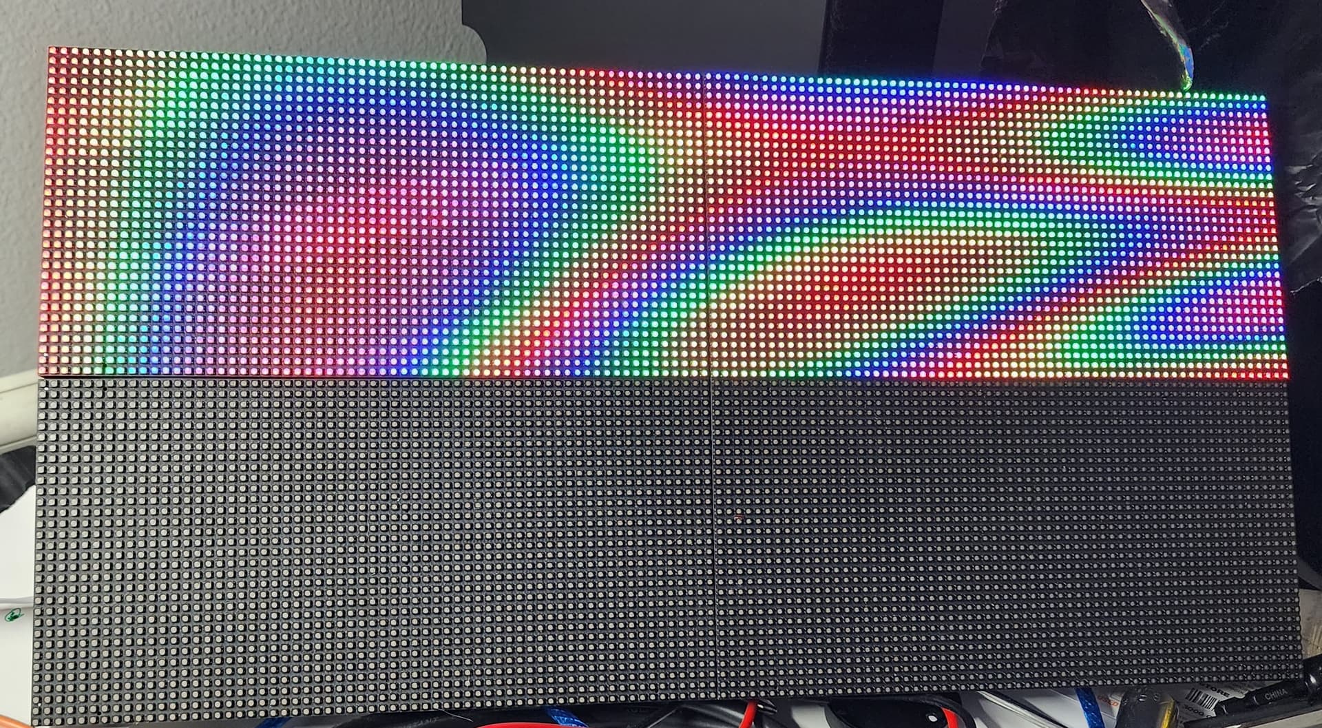

however the plasma display is only on half, no biggie not going for that.
