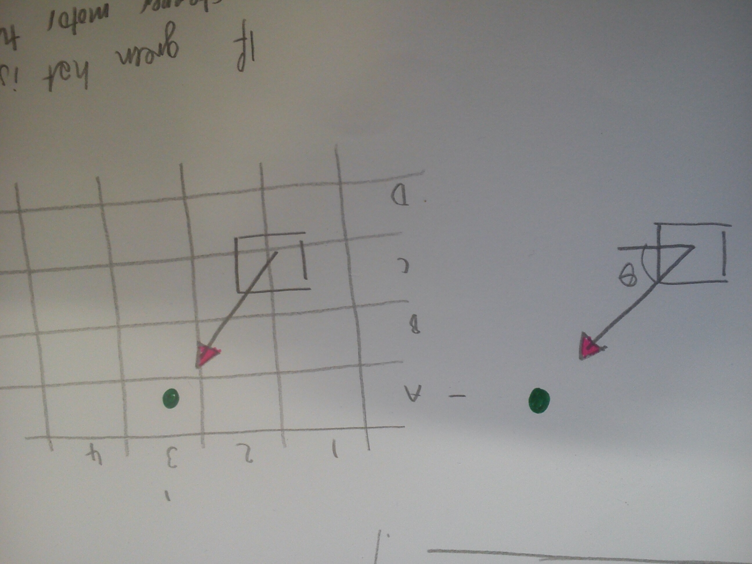

Hello everyone,
I am trying to use opencv and visual studio to create an art installation that follows the viewers. So far I have managed to setup a webcam mounted on a servo that follows a green circle. However I would like to make the piece rotate 360 degrees so I want to use a stepper motor, I wouldn't be able to mount the webcam on the piece because then the cables would get tangled, so it would seem logical to mount the webcam on the ceiling.
In MS Visual I get 3 windows when I run my C++ file, a live feed from the webcam, a processed image showing chosen colour, and a series of co ordinates of the circle being detected.
Is it possible to use these co ordinates to determine what position the stepper motor should turn to.
![](http://2013-10-17 17.48.35.jpg)
So if green circle is in A3 stepper motor should turn to ?
This is how I see the project to be laid out please excuse how crude this whole project is I have only just started with arduinos and programming.
Below is the code that I got from the very kind http://aleksandarkrstikj.com/
Any tips on how to modify this to suit my project would be greatly appreciated.
