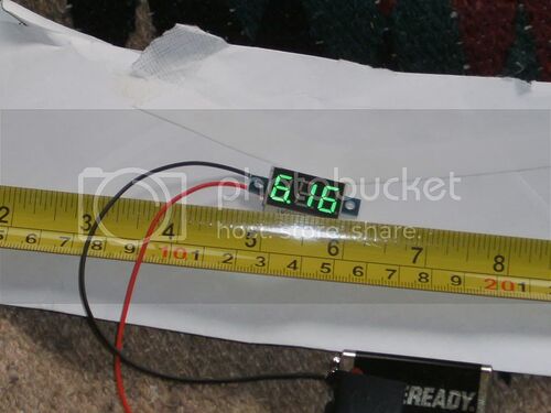

Also all of this will be running from a battery, I've got some Pololu 5V Step-Up/Step-Down Voltage Regulators so we've got flexibility on what batteries we can use.
Do you have any suggestions for a voltage monitor to connect to the batteries directly?
I'm going to send this data back to the pit so we know when they need to be changed over.
Thanks again for all your help so far mate. :slight_smile:
A Digital voltmeter would be fine:

I think if I do a voltage divider to take a maximum of 11v and feed out 5v I should be able to relay that back to the pit
