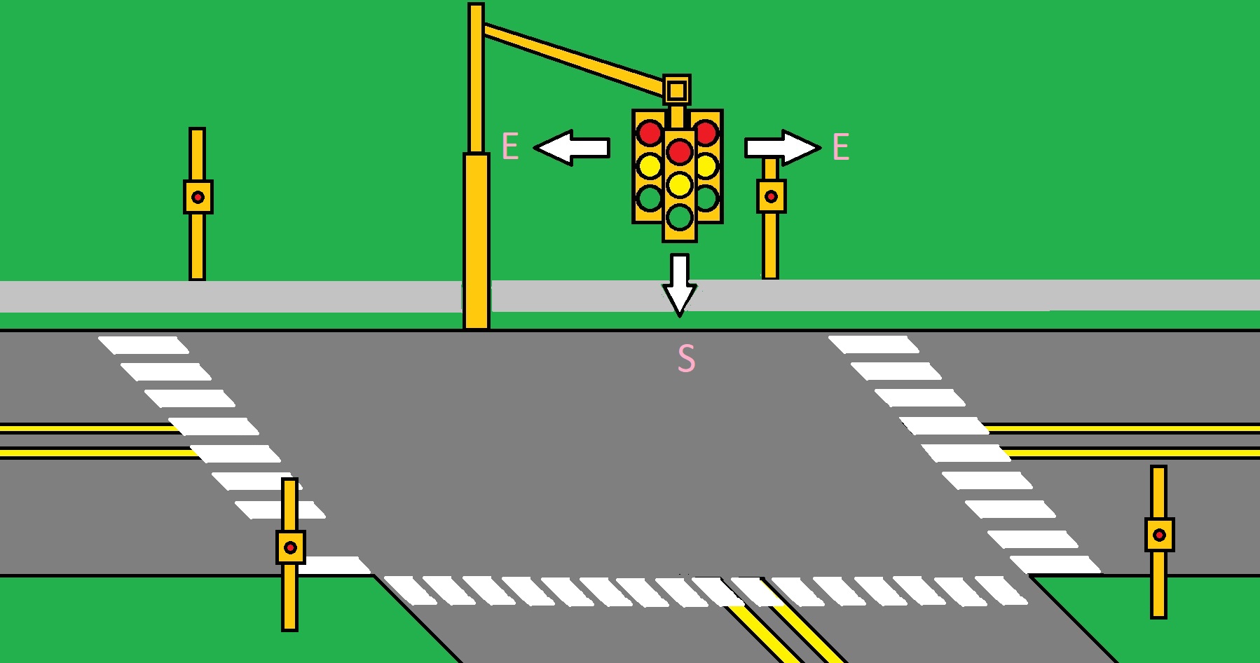

I'm not clear now what the traffic light arrangement is you're modeling. It looks like you have an eastbound light and another westbound. It might be clearer if you can post an image of the intersection you envisage it controlling and what the light pattern should be.
With multiple light installations, I'm not sure my state names make sense any longer. Red by itself doesn't tell you much - red where?
But as always with Arduino stuff, easy enough to test. Let us know how it functions.
First off, dont make fun of my MS Paint skill, lol. I just threw this together. While drawing it I realized that the logistics are a bit off, but as long as the sketch is doing what I want to do, and I understand how I made it do that, changing it will be much easier. My eyes were going crossed when I was trying to visualize the sequences earlier today, lol.
I guess in this image I would have the W labeled functions be south, and E would be east to west. Of course I would have to modify a few things to make the sketch reflect how the image should work. baby steps.
