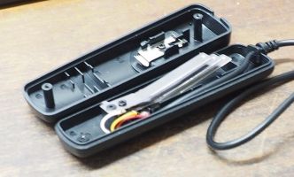

If your camera has some dumb proprietory socket, a cheapo eBay remote is probably the best way to get the plug. I think mine cost about $6. I imagine they all work the same, being a two stage switch to provide for autofocus. This means you may be obliged to use two isolators. I'm not interested in autofocussing but I imagine it just means a slight delay between the two triggers, and it wouldn't be anything critical.
PC220008
If you get rid of the mechanical gear, there would be plenty of room for the optos etc., as proposed above. Indeed, if you want to get really smarty-farty, I bet you could get an ESP8266 in there, complete with battery, and have the whole thing controlled by your phone.
