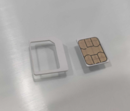

I received yesterday my brand new Arduino MKR GSM 1400 and started playing around with today.
However, I'm having trouble stablishing the connection with the SIM card. I'm using the "ReceiveSMS" example from the MKRGSM library (code below), but the execution is getting stuck at the gsmAccess.begin(PINNUMBER) command.
Using AT commands and the debug mode, I got the following description for the error message:
AT+CPIN?
+CME ERROR: SIM not inserted
I have tried connecting with 3 different SIM cards, all tested beforehand with a smartphone and confirmed to be functional. I have tried removing the PIN, but still got the same error.
Here are some pictures displaying how I'm handling the SIM card insertion.
pic1 pic2
pic4 pic3
Does anybody have any idea on what could be going wrong?
Thanks in advance

The insertion is correct. Strange. Can you post the whole AT console log?
Insert your sim card and run the
  1. GsmScanNetworks and
  2. TestModem
    sketches in the IDE for your board. These will show if your board connects to the carrier networks around you and also show if your board's modem is functional.
