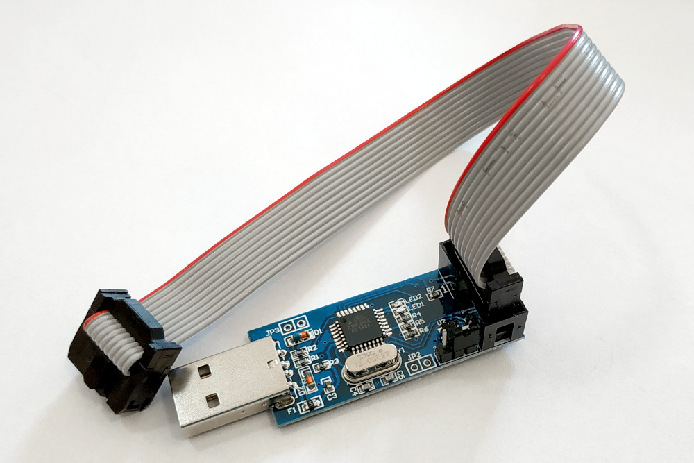

Hi @mowarrad1. I have experienced this error under either of the following conditions:
  • Incorrect wiring between the USBasp and the target (e.g., having the cable plugged into the ICSP header backwards)
  • Target clock is <=1MHz, USBasp is flashed with the official "Fischl" firmware, and the "Slow SCK" jumper is not shorted.
    On this common USBasp model, the "Slow SCK" jumper is marked "JP3" on the PCB silkscreen:

Hey @ptillisch
Sorry for the late reply! And thank you for answering:)
  • I'm pretty sure it's connected correctly, else I wouldn't be able to upload any code:)
  • Honestly I don't know if its flashed with Fischl firmware, I bought it from a local retailer. Do you maybe know how I can check which firmware is installed. Should I update the firmware eitherway?
  • I tried shorting the JP3, but got the same error.
Your claim of being able to upload contradicts your previous statement:
There is a nice alternative firmware that was produced by some of the Arduino community members:
However, the firmware update process is fairly complex and the firmware the USBasp comes with is perfectly fine for most use cases. So I would say that you should only update the firmware if you have a specific reason to do so, or if you think performing a firmware update is something you would enjoy just for the experience (accepting the risk that you might "brick" your USBasp in the process). If the problem still occurs even with JP3 shorted then I don't think updating the USBasp firmware will solve the problem you are experiencing currently.
