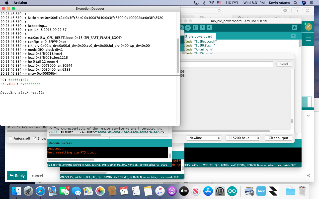

Interesting theory, worth checking out.
@kevina654, try adding to setup():
Serial.println(serviceUUID.toString().c_str());
What does it print?
"eb:56:d2:fb:28:ec"
If you know the specific address of the server you want to connect with, the I think you should be using it in this section

Run that through the ESP Exception Decoder.
Okay, I ran the Decoder, though I'm not exactly sure how it is supposed to work. I pasted the exception text and got a 'Decode Success' message, but not sure what to do from this point.
I don't understand, but when I paste the backtrace you posted in the Exception decoder I have installed in my IDE, I see more detail.
PC: 0x400d1e2a: CPixelLEDController(EOrder)66, 1, 4294967295u>::show(CRGB const*, int, CRGB) at C:\Users\cattledog\Documents\Arduino\libraries\FastLED/controller.h line 229
EXCVADDR: 0x00000000
Decoding stack results
0x400d7d40: BLERemoteService::retrieveCharacteristics() at c:\users\cattledog\appdata\local\arduino15\packages\esp32\tools\xtensa-esp32-elf-gcc\gcc8_4_0-esp-2021r1\xtensa-esp32-elf\include\c++\8.4.0\bits/stl_tree.h line 2320
0x400902da: _ungetc_r at /builds/idf/crosstool-NG/.build/HOST-i686-w64-mingw32/xtensa-esp32-elf/src/newlib/newlib/libc/stdio/ungetc.c line 203
I don't really understand, but its possible that you are seeing the crash from something related to FastLED and not BLE. I do see many warnings related to FastLED when I compile.
You did say all was working correctly except for the connection, so I'm confused. Perhaps you can write a simplified sketch which just connects and prints the characteristic without the FastED display.
Without a power meter, it's really difficult for me to help debug this. :frowning_face:
I think at this point, you are connecting with the correct address, but there may be an issue with either the characteristic or the Fast LED display, but I'm not clear how this would be related to the connection.
I believe that indicates an attempt to de-reference the NULL pointer. Could be caused by an overflow of the process's stack. Or something completely unrelated. Since ESP32 has built-in FreeRTOS, I prefer not to follow the Arduino 'loop()' paradigm for this processor but use the muti-tasking capabilities of the OS. That helps in debugging when things go wrong and it's using the processor / OS combination as intended.
