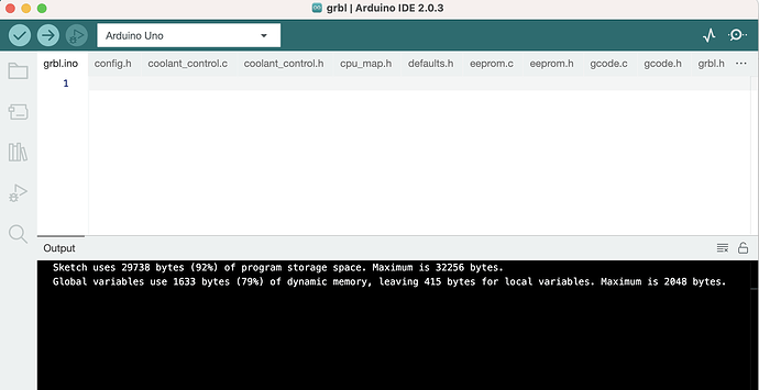

Per [Compiling Grbl · gnea/grbl Wiki · GitHub](https://github.com/gnea/grbl/wiki/Compiling-Grbl#build-as-a-normal-arduino-ide-project) I just tried:
cd ~/Documents/Arduino/
mkdir GRBLTEST
cd GRBLTEST
git clone git@github.com:gnea/grbl.git
touch grbl/grbl/grbl.ino
Then opened up a freshly installed Arduino 2.0.3, opened the grbl.ino file, chose an Arduino Uno, hit the compile button and success:
 ![image](https://europe1.discourse-cdn.com/arduino/original/4X/3/5/9/35909d4b7f7c894d3205f19a346bd9354573ca22.png)
