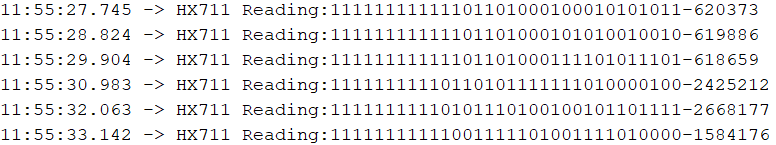

  2. The value obtained from the HX711 is drifting continuously.
    Though this value is drifting continuously, I am getting 16 stable bits for 2 minutes.
But after 2-3 minutes the values start to fluctuate largely. I am only getting 9 stable bits.
The readings shown here are average of 10 readings. I am using shielded cable (CAT 7) from strain gauge to HX711 in two wire configuration.
Connections
I'm not sure what could be causing this drift? What is the best ways to resolve this?
