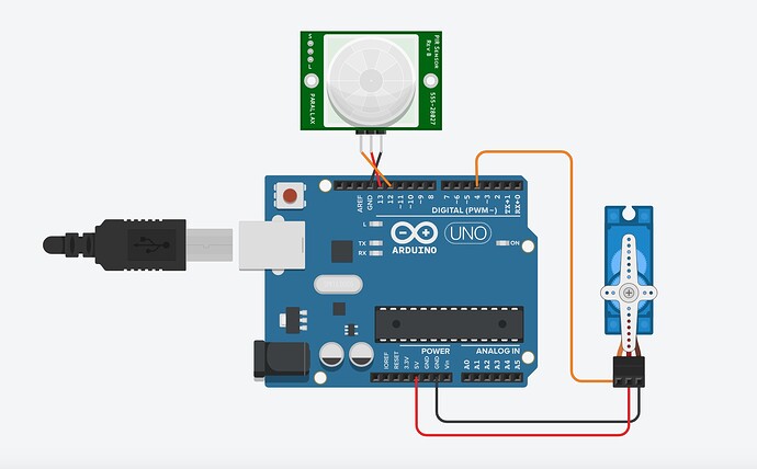

UPDATE: I got the code to upload by switching to the other USB port on my Mac. The code uploaded but now nothing is happening even if I upload the old code that was previously working. Checked all the connections and they seem to be good. I am trying to troubleshoot and wondering if there is an easy way to isolate the issue. Is there some way to tell if the PIR signal is reaching the board? Is there an LED on the board that lights when its receiving input?
Provide a wiring diagram. Indicate device pins and power supply.

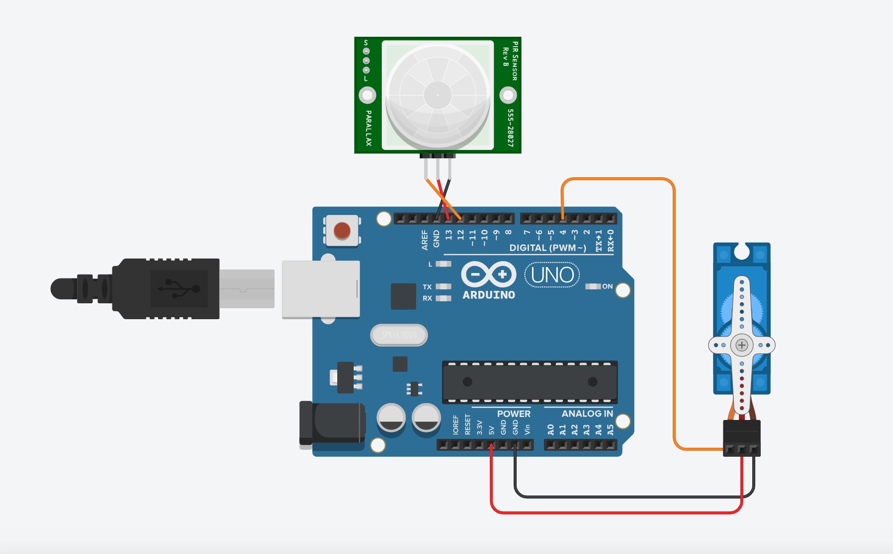

Here is the wiring diagram
I realize I need a separate power source for the servo when I use this for real. I was just doing it this way to test the circuit and the sketch.
The servo might be drawing too much power from the Arduino during startup, when it seeks 90 degrees, immediately. Disconnect the servo and run the program again.
