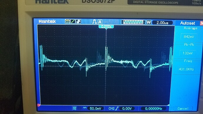

i hooked the data line to my oscope and took a couple of pictures. the display is very erratic. both the MEGA and the NANO show erratic analogRead values. in looking at the oscope display (see attached), i am not surprised. what bugs me is how the Weather Wizard III doesn't seem to have the same problem. it shows a stable resulting temperature.
maybe there is some filter being used. any suggestions ?

Is that the Weather Wizard III with the temperature sensor on the 25 foot (7.6m) cable? The cable may be acting as an antenna...
yes it is. but i have the cable coiled up by my test bench.

Use a big capacitor over the sensor signal to flatten it out. It's a rather strange signal graph for a temperature sensor...
yes, it is a strange signal, and i guess it is my fault. i finally figured out that if i have the usb connected to the MEGA, i get that junk signal on the data line when using A6. i changed to A13 because i can get a better connection under the large LCD shield. now i got a reliable DC signal and was able to fine tune the mapping.
