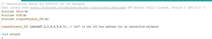

Using IDE 1.6.11 and loading the zip file into Documents/Arduino/Library
The code in post #4
Then using SKETCH.. Include Library.. Add Zip.. finding the zip file I down loaded and selecting it, allowing for it to be included.
Note my screen, the brown highlighted library items.
It compiled for Arduino UNO.
Note ALL three library items are brown.
Tom... :slight_smile:
