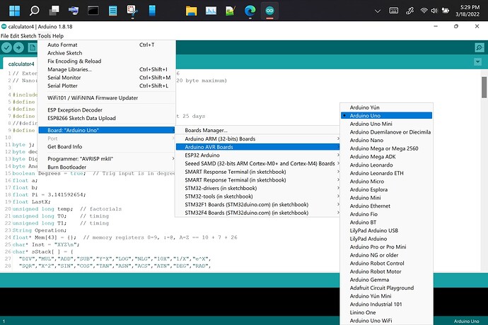

  • Connect UNO via USB to PC
  • Select your board:
  • Select Tools/Port:
  • Compile & Upload:

The Rx and Tx pins on the UNO (usually identified as pins 0 and 1) are connected to the on board USB to serial interface and are used to communicate with the serial monitor in the IDE as well as upload sketches.
In order to use the interface board you have, you would need a software serial port - just use one of the software serial libraries that already exist. Connect the pins used by the software serial library to your RS232 interface module Rx and Tx pins and you should be good to go.
Note that with a software serial port, the baud rate is quite low, 9600 or 19200 baud max. No 115200 baud.
