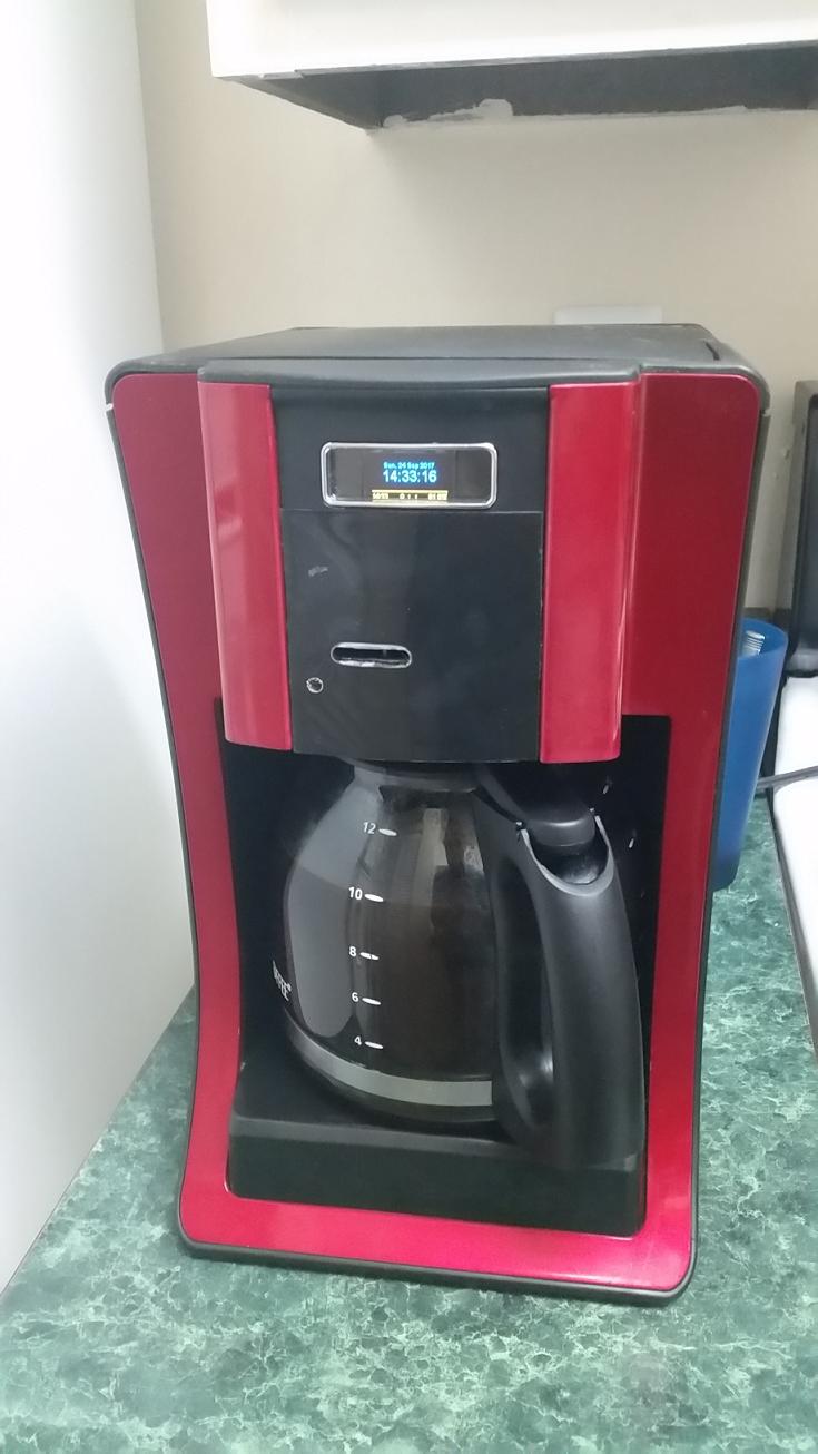

Yeah I had been getting the on/off msg lol that was what was really twisting my noodles. but it was my only day off with a few other things to get done later and very little sleep.. As soon as I posted and logged off I found I missed one little thing in the 3+ attempt... I forgot to change the Pin assignment from D3 to D8.. I changed it, uploaded and booya it worked..
If I can bend your ear for a sec..
Would adding the OTA and a scheduling routine consume too many resources?
Is there a simple 2 or 3 line of code that I could make an "Auto Off" after the On command
I have a push button set up on gnd/D7... would adding a "change state" to the button be sufficient for on/off?
Posted a few pics of the maker.. still have to fine tuning the faceplate template.. and I think I am going to go with a wider display..
