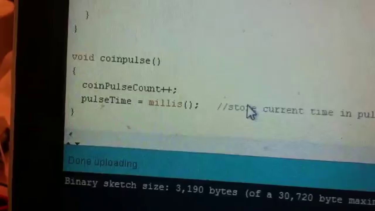

There's a youtube video that you may find useful as the author describes how they do the detection of the various coin denominations:
