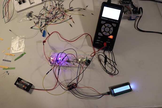

I am working on a custom project that involves a DC-powered circuit.
The circuit is parallel: each components is wired in parallel.

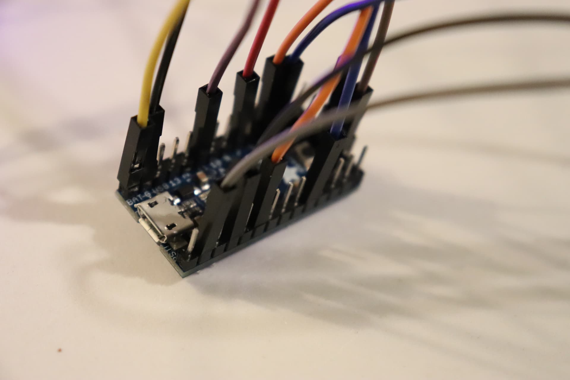

The circuit involves two switches for component control. The first switch turns an LED on/off and an Arduino with I2C LDC on/off. There is a power indicator LED before the first switch. The Arduino an ItsyBitsy by Adafruit.
The idea is to get the Arduino to power a pin once a power-detector pin has power. The detector pin is powered by turning ON the second switch.
I am having trouble with the Arduino in that it is ignoring the power-status of the second switch. The second switch is OFF, meaning the detector pin has no power, but the Arduino is still acting as if it was powered. I can pull the detector pin out of the breadboard and it is still acting as if the detector wasn't there.
The IDEA is that once the second switch is ON:
  1. pin11 reads HIGH which causes pin7 to write HIGH.
  2. pinA8 now reads what its detecting and the Arduino does some calculations.
  3. IF: pinA8 is >= 263, THEN: pinA5 is HIGH.
  4. IF pinA8 is < 263, THEN: pinA5 is LOW, AND pinA1 is HIGH (pinA1 is a function ALARM).
But what's going on here is that pin7 is disregarding the control status of pin11 - pin7 is always on an cycling.
I need pin11 and pin7 to behave properly, otherwise the red and green LEDs are always on when they're supposed to be controlled by switch 2 and pinA8 respectively.
Any help would be great. It's a 5V circuit.
What's really going on here is that the code runs fine when plugged into the USB, but when the USB is unplugged then he red and green LEDs blink when the pin11 is off. The whole thing works fine otherwise (i.e., when the switch is on).
I have posted the script and some pictures for assistance below:

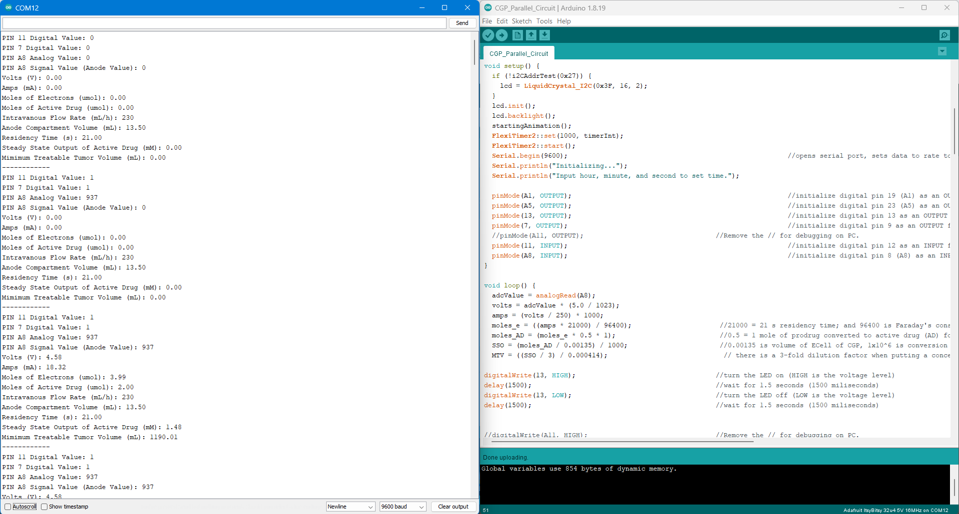

I am ultimately asking why the program works when plugged into a USB and not when powered by a power supply.
This question has been asked several times before on the forums in general and, so far as I've been able to find, which is typically quite exhaustive, still actually hasn't been answered anywhere on this Arduino forum community.
So it's not a schematic requirement question in the slightest.
Insert serial prints to make sure that calculated values makes sense.
I've uploaded SS of what it looks like when it runs.
The first scan is with the second switch OFF.
The seconds scan is with the second switch ON.
And the third scan is with the second switch ON and a cycle has passed.
You will notice that the PIN 11 and 7 got from 0 to one from the first scan to the next, and the calculated variables have about a one scan lag (from scan two to three).
