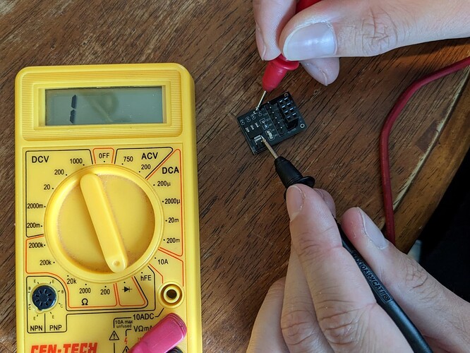

**Problem:** I cannot successfully execute the "Simple one way transmission" demo code from Post #2 of [Simple nRF24L01+ 2.4GHz transceiver demo](https://forum.arduino.cc/t/simple-nrf24l01-2-4ghz-transceiver-demo/405123/1). The transmit side reads endless lines of "Data Sent Message 0 Tx failed" while the receive side shows only "SimpleRx Starting."
**Background:** I have been attempting to learn how to use RF transmitters for an upcoming project. I started with [DroneBot Workshop's tutorial](https://dronebotworkshop.com/nrf24l01-wireless-joystick/#Power_Supply_Considerations) followed by the [How to Mechatronics Tutorial](https://howtomechatronics.com/tutorials/arduino/arduino-wireless-communication-nrf24l01-tutorial/). After a string of failures with the aforementioned tutorials, I found Robin2's "Simple one way transmission" tutorial. After those demo codes failed to yield desirable results, I began further troubleshooting. I have spent the past few weeks pouring over similar forum inquiries and applying the suggestions to my problem. This was to no avail.
**Setup:**
I am using the NRF24L01+PA+LNA modules with the external antenna and the necessary breakout boards. They are connected to Arduino Unos (1 genuine, 1 clone by ArdiBot) and powered with external 12V power supplies. Both systems are exact copies of each other and one of the setups is pictured below.
 ![RF Setup (1)](https://europe1.discourse-cdn.com/arduino/original/4X/c/5/7/c578e0452bd4abb97b43fb04ddf4ee7b0967735c.jpeg)

**Attempted Fixes:**
- using breakout boards instead of direct wiring with a filter capacitor
- using other nRF24 modules (rotated through 6 total)
- cutting power to modules after each new upload
- adjusting power [radio.setPALevel(RF24\_PA\_MIN))
- adjusting data rate [radio.setDataRate( RF24\_250KBPS ); & radio.setDataRate( RF24\_1MBPS ))
- changing auto acknowledge (radio.setAutoAck(false))
In closing, this is my first post. My apologies in advance for any formatting errors or if I forgot to include anything. Any help is greatly appreciated.

> [@justin1](#):
See time 10:29 re miss labeled pins.

Thank you, but I have tried that. The programs still do not function properly. Furthermore, when I run the CheckConnection.ino program it fails.

> [@justin1](#):
Maybe faulty modules or wiring then ?
<div class="post-metadata">
**Author:** ![markd833](https://dub1.discourse-cdn.com/arduino/user_avatar/forum.arduino.cc/markd833/32/1186928_2.png) [@markd833](https://forum.arduino.cc/u/markd833)\
**Post date:** [March 9, 2023, 8:32am UTC](https://forum.arduino.cc/t/troubleshooting-help-for-simple-nrf24l01-2-4ghz-transceiver-demo/1099625/5 "2023-03-09T08:32:53Z")
</div>
> [@justin1](#):
Can you expand on this?
What does the CheckConnection sketch show in the serial monitor?

> [@markd833](#):
Swapping the MISO and MOSI pins yields the following result.

> [@srnet](#):
1. I have tested 6 different modules from two different suppliers in both transmit and receive roles. It seems improbable that all units are faulty.
2. If the wiring was incorrect wouldn't the CheckConnection.ino expose the problem?

Post #6 appears to show that register reads to the NRF24 are all returning 0xFF ..............................
From the printout you posted;
```cpp
If the numbers are mostly 0x00 or 0xff it means that the Arduino is not
     communicating with the nRF24

The problem was hardware related. The filter capacitors were not connected to the ground plane on the NRF24L01+ Power Module PCB. This was tested using a multimeter checking for continuity (shown in the picture below).
 ![Continuity Test 1](https://europe1.discourse-cdn.com/arduino/original/4X/5/9/a/59a2ba915375911b59f6ef5d695eea2935f5afb9.jpeg)
The points tested were the ground pin of the module and the via, which is supposed to link the top ground plane of the capacitors to the ground pin. The points tested for continuity are shown by the red arrows in the picture below.
