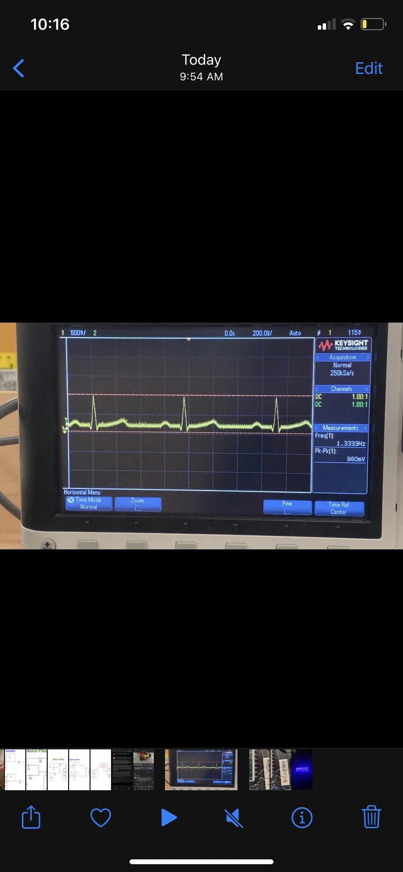

I have this code that I made to get the ECG on the serial plotter, however it's really noisy, I don't understand how to make it less noisy and more clear like in the oscilloscope:
Also, I'm not getting the right BPM, please advice.

Think about this. First time that your signal is over 100, bpm is incremented and multiplied; so now is 6. Next time through loop, you multiply again and bpm becomes 36 (signal < 100). And the third time through loop() (signal < 100), bpm is multiplied again and becomes 216.
You also never reset bpm so it will overflow.

The oscilloscope is taking 250,000 samples per second.
Your sketch with a delay of 90ms between readings takes 11 samples per second.
You need to take readings more frequently (lower delay) to get a nicer looking trace.
It;s a breadboard, and I'm not using sensors at all. I'm connecting a wire to the patient simulator directly. I'll make the changes to stop the circuit to do the calculations better. Thank you
So, you're saying that's better if I have my delay maybe at 10ms? Sorry, I'm trying to understand.
