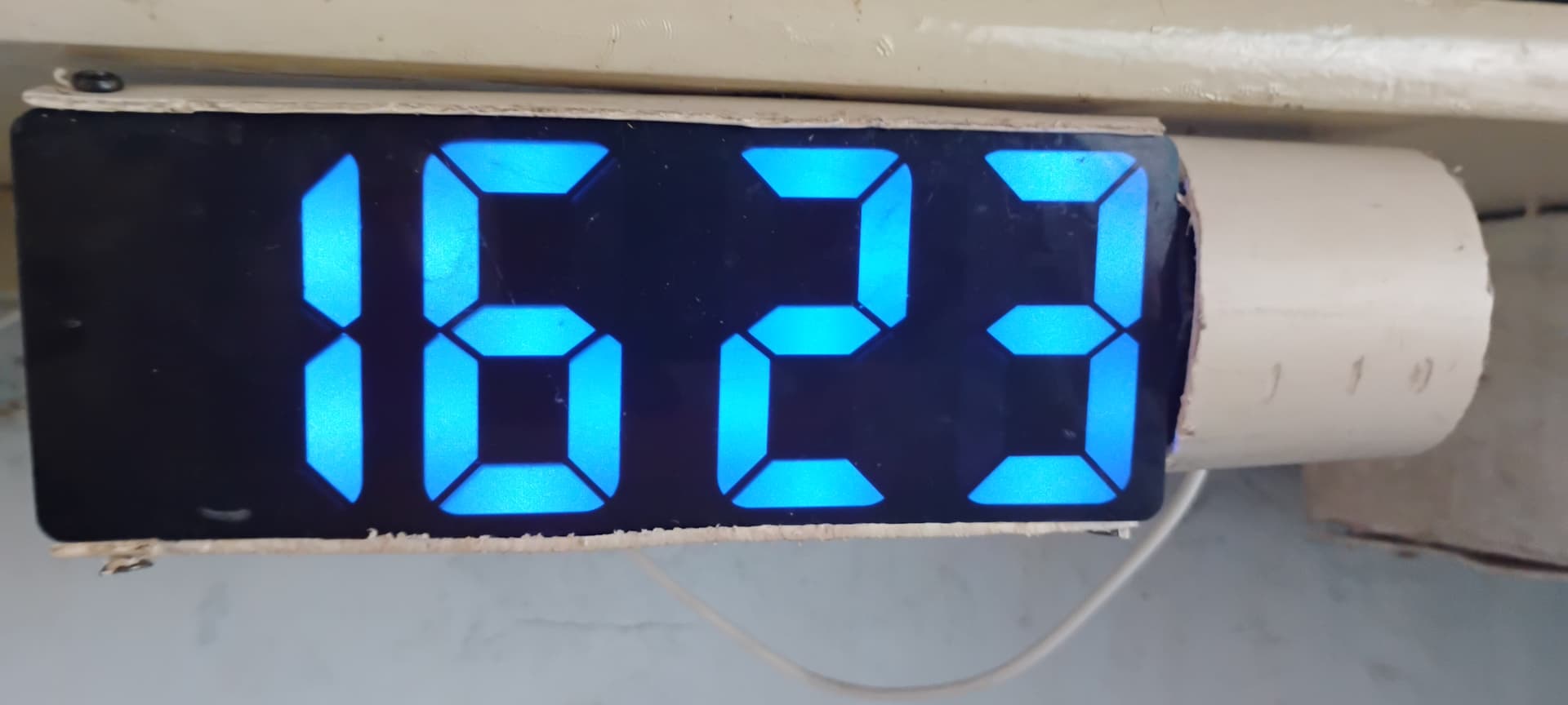

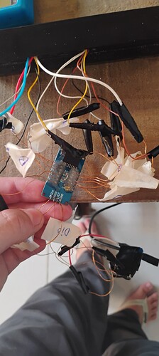

I succeeded in making a clock using an ESP8266 and a 7-segment display. I removed the original 7-segment display and replaced it with a 5V LED to function similarly to the original display. Like in the Photo:

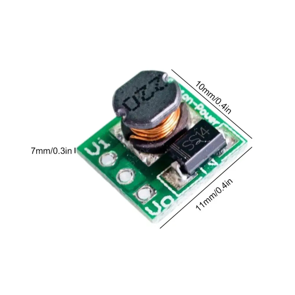

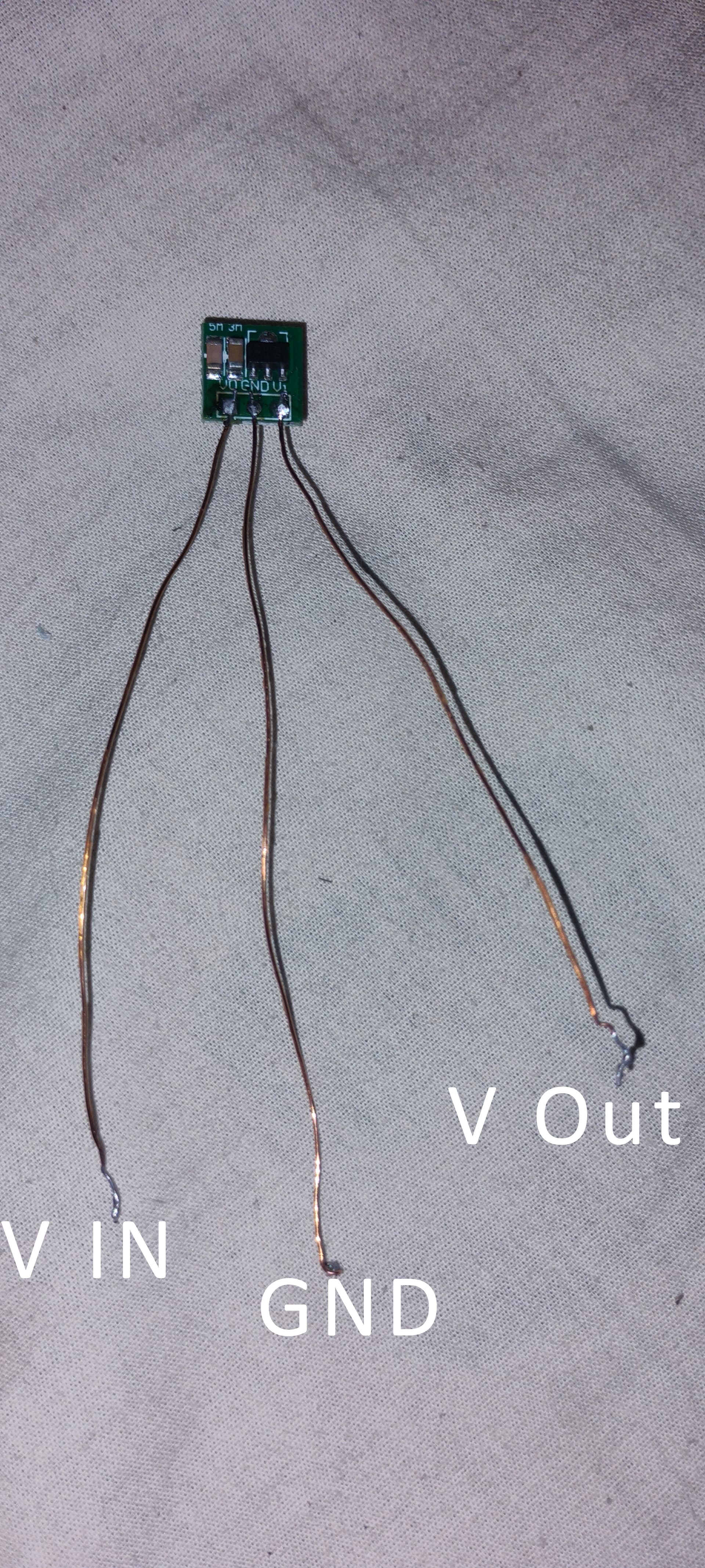

I am trying to boost the LEDs, to be brighter, so i bought this Converter Module: and connected to test if it is going to be brighter, but it is the same brightness!
I cannot figure out what can i do to make it brighter?

LEDs are current driven, not voltage driven, so the brightness depends on the current. The supply voltage must be above the minimum required by the LED display.

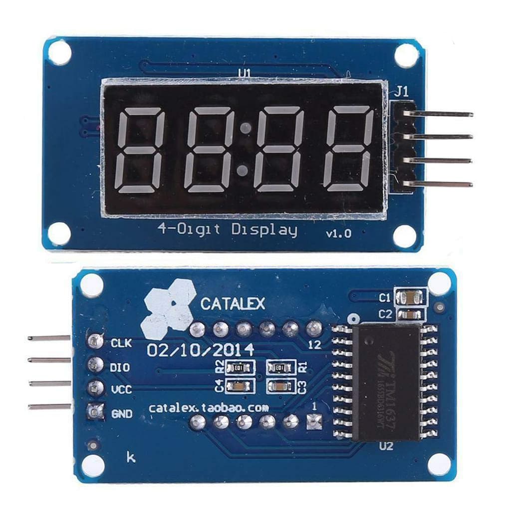

Most TM16xx chips are intended to be connected directly to LEDs that match the power specification of that chips. To a certain limit you can connect the chip on the module to different type of LEDs that are brighter and perhaps consume a bit more power than the 4-digit LED display on the module. Some years ago I experimented with theses modules and modded one into a LED&KEY module and another one into a 6x5 mini LED matrix module.
To use the TM1637 at it's highest output you should power it by 5V and not by the 3.3v that the ESP8266 uses. Perhaps best is to use a separate power supply and share common GND connection. The ESP8266 has 5V tolerant data pins, so that should be fine.
If you want to drive the LEDs at even more power, you cannot just use a boost converter. You need to make the TM1637 switch higher currents instead of driving the LEDs directly.
