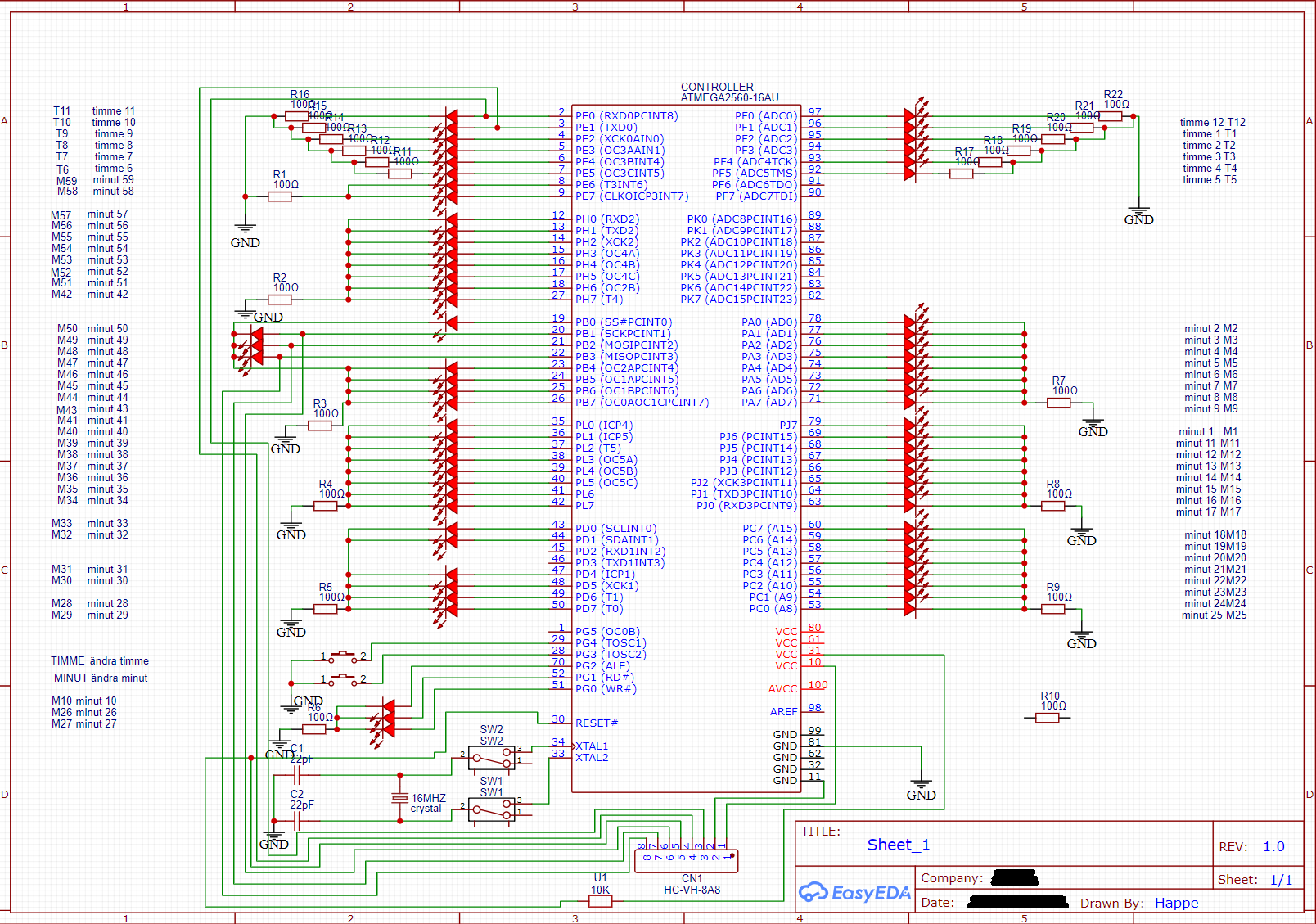

there is my schematic. im learning so i probably have done som questionable connections and all that so don't judge xD. and i connect wires from my arduino uno to my own circuit board. and for more information the led connected to pin 2 and 3 on my own circuit board is always on when i plug it in and pin 26 is flashing.
Nice to see a clear schematic! I see potential problems with switches in the crystal connections. Also you do not have any bypass capacitors. You might want to check your current, the ATmega2560 has an absolute limit of 40mA on each pin, and 200mA in total for all pins. Exceeding this even momentarily could destroy it.
I don't understand why that would need to be changed. The difference between 0xD8 and 0xD9 is the BOOTRST bit, which caused the processor to execute the bootloader after a reset. There would not be any reason to change this because you want the bootloader to execute.
The LED and 100 ohm series resistor on the Rx pin is definitely going to cause problems. The Tx line from the atmega16u2 on the UNO has an in-line 1K ohm resistor. There will never be enough voltage on the Rx pin of the atmega2560 for a HIGH.
Also be careful of the current rating of the LEDs. At 5V, with approximately 1.7V drop across the LED, the 100 ohm resistor will limit the current to 33mA.
I'm a bit surprised the ISP programming worked with the LEDs on the SPI pins.

Lets see, 60 LEDs for the minutes, 12 for the hour, that is a total of 72.
A grid of 8 x 9 will drive the entire thing with 17 I/O pins using multiplexing (even less with charlieplexing), but with only a single minute and a single hour LED being lit at any given time, you can bypass the normal multiplexing operation and just drive the two desired LEDs 50% of the time each. No real need for the relatively huge atmega2560.
