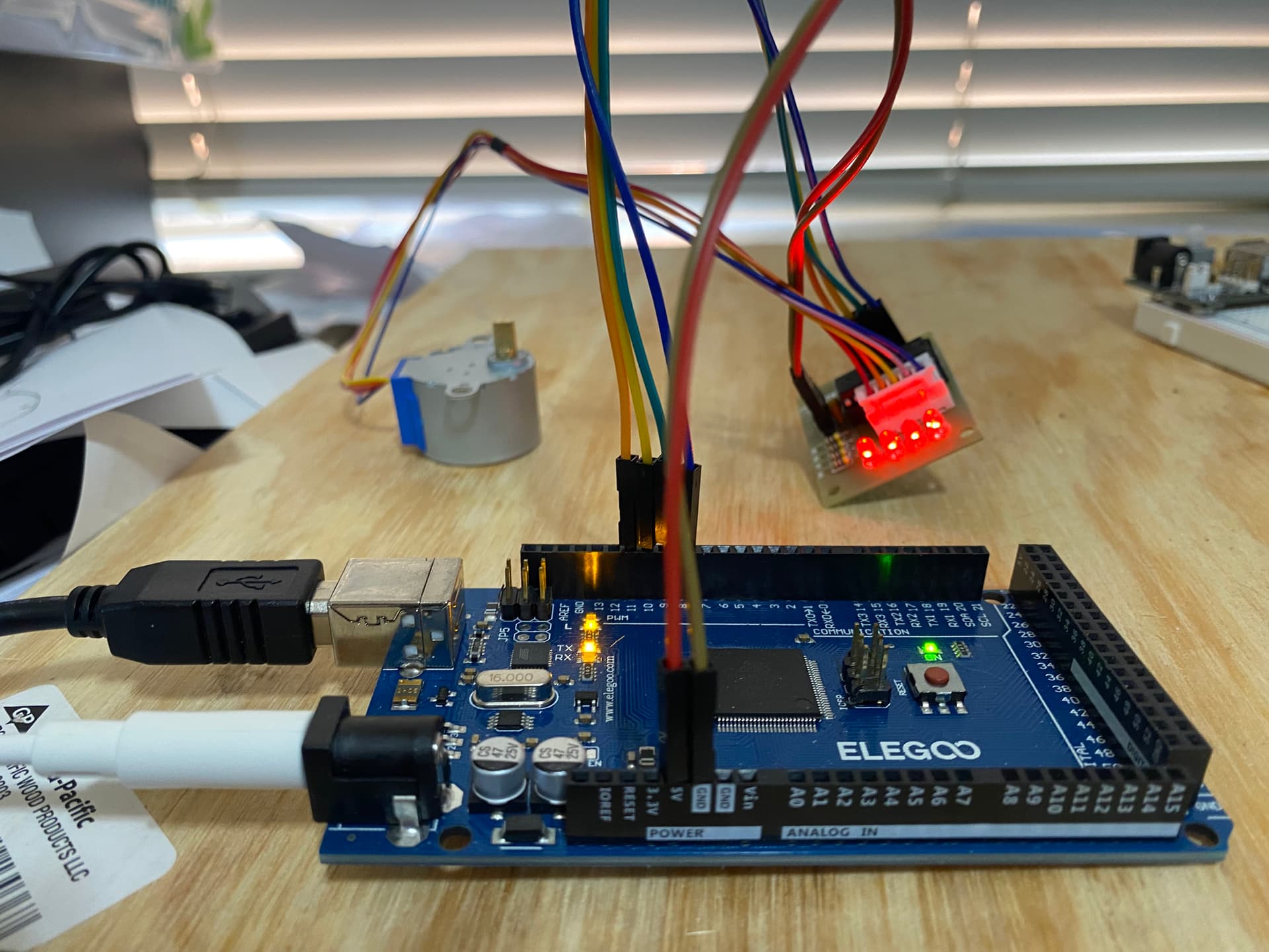

Still trying to debug this. Motor is 28BYJ-48 5v. Controller is referred to as ULN2003, but it is a board, not just an IC chip.
Pins 1,2,3,4 on the motor controller go to pins 8,9,10,11 on my Mega board. I've seen instructions with those wires reversed. Neither option works. If I comment out "If Serial.available()>0" I can get it to print stuff to my IDE. Lights are on, but the motor is not turning. Motor got hot at one point. I switched to another motor of the same make, still no motion. HELP. Also, on the motor controller, all examples I see show putting the power wires into the 5v side, but my board will not light up unless I use the 12v side.

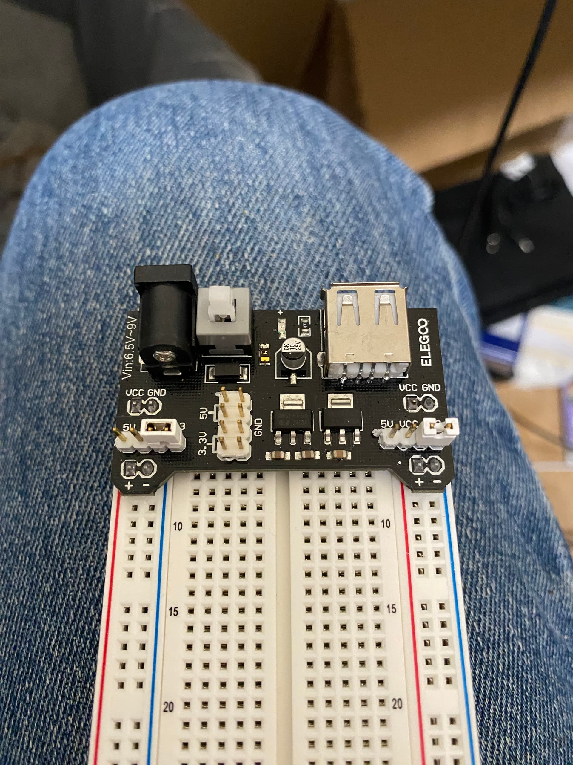

I tried powering it from this item, and it gets no power. Other examples I see on the web show it powering from the Arduino, but I'm also using an AC to DC 9v converter to power the other port on the Arduino. But, I could be wrong in what I'm doing.

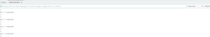

This is what I see on the Serial Monitor. There is an input field at the top, but what do I input there to send to the arduino?
That motor draws about 350mA.
A breadboard supply powered with 9volt input would struggle (getting hot) to deliver that current.
Stick with powering the motor directly from the Mega (on USB supply).
Leo..
I entered a value in the Serial monitor, but no movement. It prints out what I entered, but that's it.
My other pertinent question is, on the controller board, why does it only power when I pin into the 12v side. It won't power from the 5v side, though I see examples where it does that.
Which board do you have. My board does not have a 12volt or 5volt pin.
The + pin is just labled 5-12volt.
Did you leave the jumper on?
Your image shows all the LEDs lit. They only should light up/flash when stepping.
Leo..
The controller board does not really have a name on it. It came with the Mega kit. It has MCU 10 down in one corner, but I'm thinking that's not a name. It does just say 5-12v. I switched the jumper over to the left side, and it started lighting up. But everything is lit from the start, before I kick off the program.
Ok, I removed the power supply from the Mega (but not the USB) and the controller did not light until I typed in '2044' in the Serial Monitor field. It looped the code twice, once showing "1", then once showing "0", then stopped looping. The motor did not move, but pins 1 and 2 on the controller stayed lit. I see code giving the stepper module pins 8, 9, 10, 11, but I see others giving pins parameters of 8, 10, 9, 11, and that is what I'm using.
