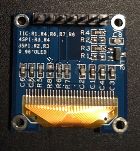

WHAT WIRES GO WHERE FROM UNO TO OLED?
Oled from left to right has GND VCC D0 D1 RES DC CS

This answer is totally without guarantee! There's no way to answer the question without knowing exactly what module you are using. "a no name brand 128X64 OLED" provides no such Information.
However, I will at least attempt to assist. These modules are often Hardware configured for either SPI or I2C (also known as IIC). Before you go any further, make sure the module is even configured for I2C. This may require adding/removing bridges or solder bridges or even cutting traces. Like I said, without knowing what module...
Refer to the following link.
That module has the same pinout as yours. As stated in the article, by Default it appears to NOT be configured for I2C and to do so would require adding SMD resistors or possibly solder bridges.
For that module, according to info in the link, you would Need to connect as follows:
VCC Power supply
GND Ground
D0 SCL (A5)
D1 SDA /A4)
Repeat! Only a hunch, due to lack of Information in the question!

PS Can you post a couple of pictures of your OLED display please? We may be able to help.
Sorry guys. I was trying not to be "THAT GUY". Was having trouble downloading the pics from my phone. Here they are:
I did Comment out for the Leonardo. Thanks for pointing that out. Zooming in on the back side; correct me if I'm wrong.. I need to Move R3 over to R8 for I2C?

marine_hm,
I'm not very familiar with that display but from the photo, it appears that the display is jumpered for 4SPI (whatever that means) not I2C.
Notice that r2 and r1 are not strapped.

Check here;
https://forum.arduino.cc/index.php?topic=342035.0
Your unit is configured for SPI.

I certainly appreciate the help. I scavenged the Oled from another project that was collecting dust. Hoping I could use it for prototyping my new project. I thought I would try out some new skills (I2C). I did purchase an oled that is I2C specific. With only 4 pinouts. I'll just have to be patient and wait until it arrives.
I'll post back when it arrives. In the meantime..... I'm going to monkey with this oled, see if I can convert it to I2C. Worse case scenario. I burn myself with the soldering iron and chuck the oled in the trash, let the smoke out of something.
