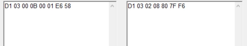

Trying to get data from sensor to Nodemcu
I am using a power meter connected to a Nodemcu through a Max485. I find difficulties on programming the Nodemcu to get the data from the sensor. I have try to use some testing software to directly send a request to the sensor from the computer and we could retrieved the correct output. But we cant get it from using the Nodemcu.
The code now we have is

This is the result we get from the serial monitor
Check if the libraries are made for nodemcu.
What would a correct output look like?
So I should use a library that support the ESP8266 like the modbus-esp8266? The correct output should contains something similar to the RHS of this picture.

The problem has been solved. Seems we follow the wrong guide of connecting the wire. This site help us to solved all the stuff.
