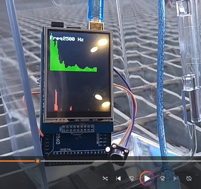

In this image I have a green graph of my initial reading of the audio, then the red is running 'live' and only showing audio that is louder than the initial reading. I want to set an led to trigger when a new sound develops but it must be 'constant' sound longer than a few seconds, so I need a way to not measure intermittent spikes like the red spikes that last milliseconds on the screen. Is there a simple adjustment I can make on the arduinoFFT reading that will only show constant audio and ignore short spikes or is this something I have to add various conditions for in the code?

The setting I have this in involves several machines and conveyor belts. I'm trying to detect audio anomalies like a failing bearing as an example. Take simplify the discussion, one conveyer has potatoes falling off the edge into a bin so you hear the 'thud, thud, thud,' above the machinery noise. I want to only show the machinery noise and ignore the potatoes falling into the bin which are only short bursts of sound. I want to only bring on a light when there is a constant noise from the machinery above the existing noise and apart from the intermittent sounds.

I've been through all of that research including the vibration analysis. The environment I want to monitor is too complex with too many moving parts and water splashing everywhere to mount monitors to all the motors. I want to make a sound analyzer - the interesting thing is that FFT is involved with both sound and vibration analysis and I want to make a vibration analyzer when I am finished this project.
One option I had thought of is to just continually run a 5 second analysis of the 'average audio' and keep comparing it with the first reading. My current device already stores an initial reading which is how I get the 'red' comparison reading.
Otherwise ..... how about a code that does a 2 second reading and reports the lowest audio in each frequency? That will leave out the short spikes, if that's possible? I don't know a lot about coding, ChatGpt has been writing these codes for me :slight_smile:

Thanks for the detailed explanation. While doing some more questioning, ChatGpt provided this for me to add 'smoothing':
    // Apply smoothing by averaging the current reading with the previous reading
      fftResults[i] = (previousFFT[i] * 0.7) + (vReal[i] * 0.3); // Adjust the smoothing factor as needed
      previousFFT[i] = fftResults[i]; // Update the previousFFT with the smoothed result

Why not? It has quietened down the intermittent spikes and given more weight to a constant audio input [me whistling to simulate bearing failure] to bring on the warning led without intermittent spikes over-ruling the constant one in focus.
