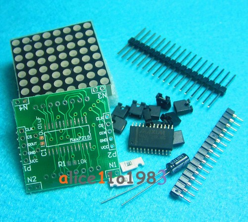

While my usual advice is to buy a MAX7219 module on eBay, the current idea can almost work, if no-one else answers in the next 2 hours I will look into it! :grinning:

That board diagram is wrong - the resistors are wrong and there are no buffer transistors.
Suggest you look for the module I cited.
