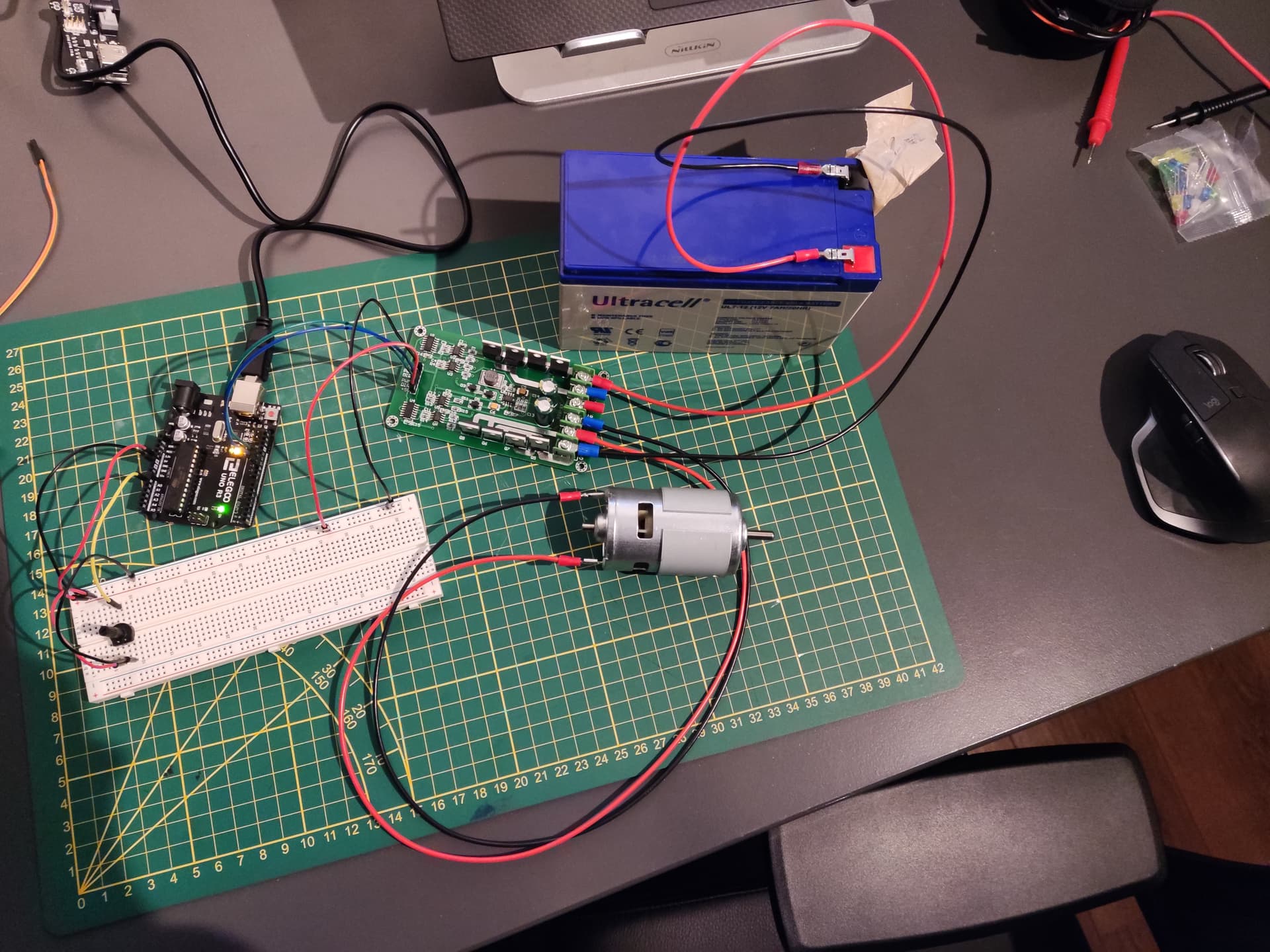

Hi! I'm trying to run a 12V DC motor using this board: https://www.amazon.nl/H-Bridge-Snelheidsregeling-PWM-module-IRF3205-Response/dp/B08JM8DCJ8
I have connected a 12V battery to the boards' power input, I have connected one DC motor to the motor 1 output on the board.
I have a wire from pin 11 connected to the PWM1, and a wire from pin 12 connected to DIR1. GND to GND and 5V to 5V.
Furthermore I am using a potentiometer to adjust the output of pin 11, which I believe should adjust the power output of the control board, and hence control the speed of the DC motor.
The code I am running is the following:

When I power on nothing really happens, I can see that the LEDs on the arduino board dims a bit. If I break the circuit to the motor driver board by removing the 5V wire, I notice that the LEDs on my arduino shines a little brighter. Now, when I take the wire and closes the circuit again so that the driver board again receives 5V, the motor spins for a fraction of a second, and the LEDs dims again, but then it stops.
This is what it looks like: Problem using IRF3205 motor driver module with arduino - YouTube
I don't understand why this is happening, am I wiring this wrong ? Is the driver board is pulling too much power from the 5V outputted from the arduino, so it shuts down - or something?

You tried to show the wiring but...... Your picture uses a lot of surface showing the physics of the boards, and that's no help. Draw a real schematics showing pin designations etc.

Can you show a photo ? Perhaps your wires are very thin or a soldered component is not soldered.

Here is a photo of the wiring, not sure it is possible to see whats going on, but maybe the schematic can support it.
