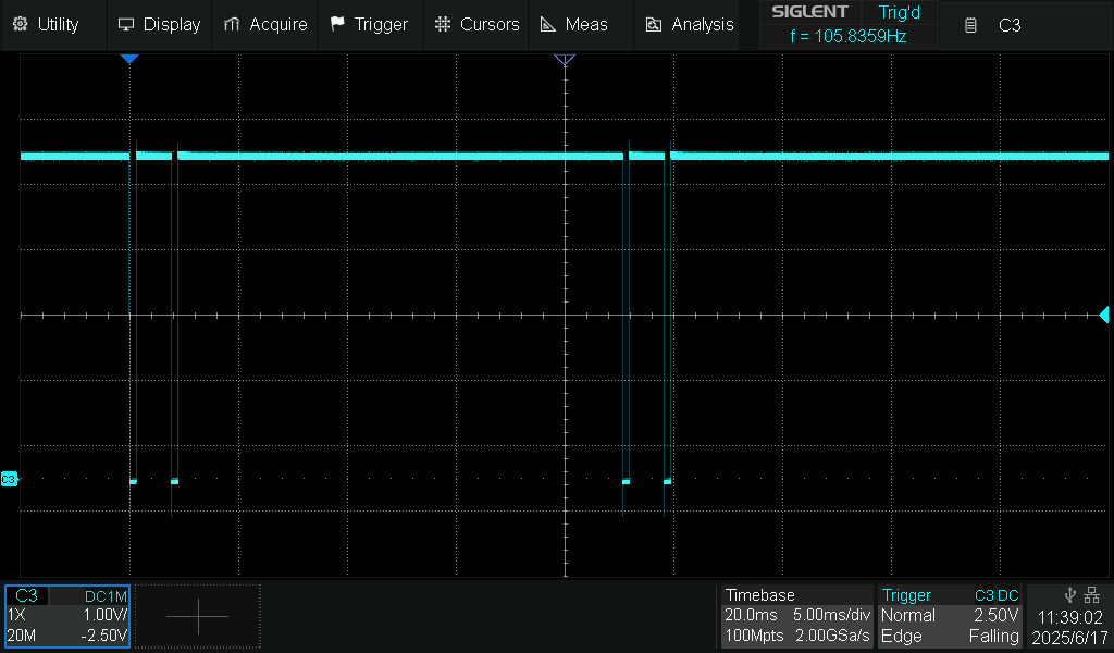

Setup is currently I'm just trying to see if I can send ppm signals to the drone. But the arduino is plugged into my laptop just running a loop for a certain value and I'm trying the view that on beta flight but it's not coming up. the Arduino is than hooked up to a tbs crossfire transmitter connect powered by the Arduino which is hooked up on 5V,GND and port 9.

#define PPM_PIN 9
#define CHANNEL_VALUE 1900 // in microseconds (can change this value)
#define FRAME_LENGTH 22500 // in microseconds (22.5 ms for one frame)
#define PULSE_LENGTH 300 // in microseconds (spacing between channels)
pinMode(PPM_PIN, OUTPUT);
digitalWrite(PPM_PIN, HIGH); // idle state HIGH
// Start frame sync pulse (Low)
digitalWrite(PPM_PIN, LOW);
delayMicroseconds(PULSE_LENGTH); // Sync pulse length
// Channel value: High pulse for the actual signal (variable length)
delayMicroseconds(CHANNEL_VALUE - PULSE_LENGTH); // pulse for channel
// Rest of frame time (idle between channels)
delayMicroseconds(FRAME_LENGTH - CHANNEL_VALUE); // Fill the rest of frame
// Repeat the process

From the comments in the code it would appear to me that you are trying to generate two low going pulses each time you go round loop.
However you only have one
and one
Thus you are only actually generating one low going pulse each time round loop().
Another issue is that there is a maximum value for the parameter sent to the function delayMicroseconds().
The largest value that will produce an accurate delay is 16383; larger values can produce an extremely short delay. For delays longer than a few thousand microseconds, you should use delay() instead.
For more details see: delayMicroseconds( ) and delay( ).
Here is an oscilloscope trace showing the result of your code:
That looks wrong to me.
Only the 300µs low going pulse is correct.
Actually, no

Is this what you were aiming for?
I added a second low going 300µs 'Stop pulse' to show that the Channel pulse has ended.
I split the 'Rest of frame' into two parts, each less than 16383µs.
Here is the revised code:

It's too soon for me to ask, but is this going for
a PPM signal consists of a long (around 4 - 5 mS) HIGH pulse as sync pulse and then channel pulses of 1 - 2 mS separated by 300 microseconds LOW pulses. Pulse period of a single channel consists of its corresponding HIGH pulse plus 300 microseconds.
Sounds like positive pulses, easy enough. The thread that quote came from is issuing one PPM train every 50 milliseconds.
