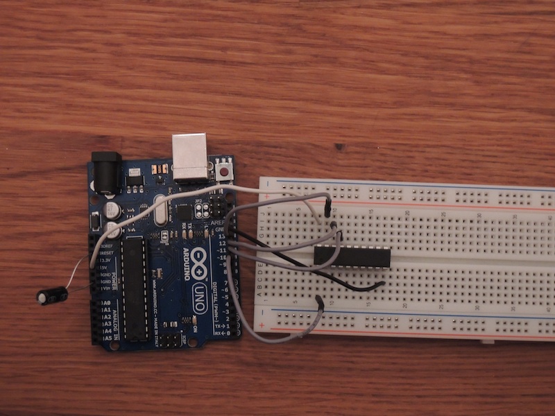

Your wiring is wrong. Very likely a short-circuit brought about when the programmer (your Uno) attempts to enable programming mode on the target (the ATtiny2313).
I suggest you put 220 ohm (or higher) series resistors on the SPI and RESET connections between the programmer and the target before you damage one or both sides.
Hm, thanks, but re-re-re-checked and checked again when you said it is wrong, I have no idea what might be wrong. It is wired excactly like it is described in the tutorial and I double checked with the picture also, just to be sure. The ATtiny2313 is not upside down. I don't know what to do different.
I guess the resistors would only prevent damage but not solve my problem, right?
gringle:
Right.
Post a picture. Ensure everything is well lit. Move the camera away and zoom to frame. Try to make it about 800 x 600.
Here it is, thanks for having a look. I kind of hope to be embarrassed by you spotting the error right away.
Perfect picture. Very nicely done.
Huh. Wiring looks fine to me.
Post the verbose output from avrdude with the target removed. (I think it will fail with a timeout.)
I will do that this evening. I'm not sure what you mean by "target removed", though. Just without the ATtiny2313?
