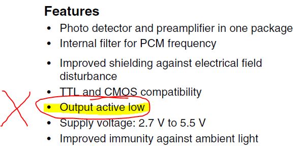

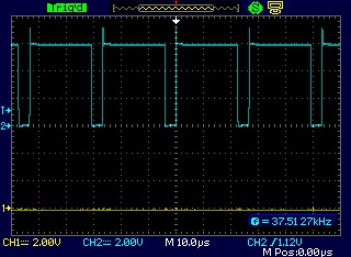

Hi, I think you will find that the output is HIGH for NO SIGNAL.
Fire a IR remote at it and see what happens.
Tom.... :slight_smile:
Yep it's active low.
'Scope shot atached shows it goes to 0 (yellow) in the presence of a 38kHz carrier (blue).
Edit: attached shot of datasheet.
