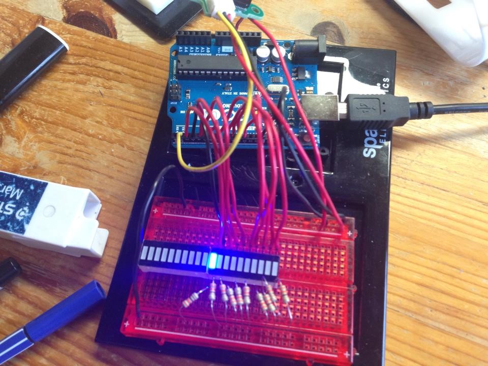

Can you post a diagram of how all the hardware (including PC, Arduino, sensor and LEDs are connected)?
You could draw one by hand and take a picture of it.
Thanks
Ray
Sure, here is the pictures:

I can see the data of the sensor in a screen in Processing. When my hand is near: 220, when it is far: 28.
Only LED 1 is high in this one.

Your photo does not show the sensor, but I think there are wires going to it. Please give more details of sensor.
Also, you have sensor connected to Arduino pin 1? This will conflict with the serial monitor. Try moving the sensor to another pin and change the pin number in your program to match.
In the pictures I sent, the sensor is the piece of hardware with a yellow wire attached to the arduino. I don't have any information about the sensor because it is a new hardware that the company I am working for is developing.
