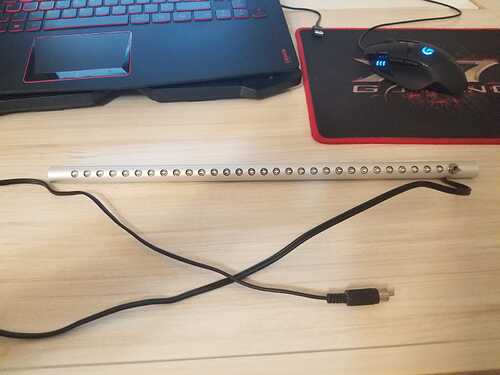

So recently, I got an LED board with an on / off switch:
As you can see, it has a weird and old power cable, and instead of spending money to buy a compatible output cable, I decided to use what I had.

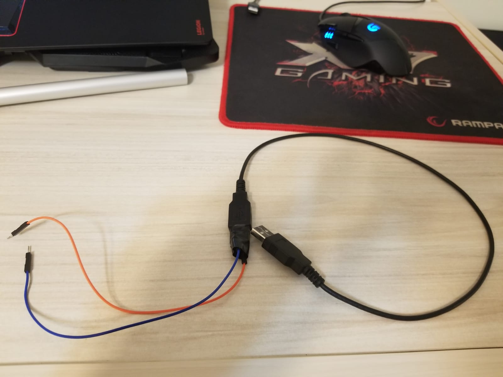

What I first did was to connect some lipo batteries and supply power to the board by touching the poles, and it worked. Then I thought batteries would be a bad way of doing this as they would constantly need recharging, so I decided to supply power from an outlet. I found a phone charger of exactly as many volts as required, and then did some soldering on a USB cable to make it a power cable:
However, when I plugged the charger and the cable, and then touched the jumpers' tips to the corresponding poles, the led board didn't light up. However, when I tried to power an Arduino with it, it worked, which means the cable is working perfectly fine. I tried a different phone charger, the same result.
So, how do I make the led board draw current from the phone charger?
You have told us little about the LED bar, and nothing about the phone charger, and nothing about the Arduino.
I count 30 LEDs. If each LED uses 10 mA, that is 300 mA right there. That may be too much for the phone charger. Most Arduinos use a lot less current.

I connected three lipo batteries directly, so that I get 11.1 - 12 volts. The led bar works with that, but it doesn't work with a phone charger of 12 volts and 2.1 amps.
Do I need a charger that can supply more current to the bar?
(Also, the Arduino did fully work and the reason I can't tell you much about the led bar is that I took it out from an old bed and no one left any data for me. I found the voltage by powering it with different amount of 3.7 lipo batteries.)

Where did you find a 12v phone charger? I see a usb plug at the other end. USB is 5v, and a phone charger with a usb outlet is going to put out 5v. Systems like QC2 and 3 can output 9 or 12v, but only after negotiating with the connected device over the data lines, otherwise they just put out 5v (otherwise they would blow up any non-QC usb device plugged into them)

So basically, a USB cable comes with a built-in 5 volt regulator? It makes no sense. If I give 12v through the power pin, I should get 12v at the other side.

USB chargers use 5V. Well some may negotiate higher currents and voltages over the USB data lines, but by default you'll not get 12V, as that would destroy any non-12V device.

Also, the 12-volt phone charger is a Samsung fast charger. I suppose there is also a software part for drawing that much electricity, I guess that's why the LED bar didn't work.
