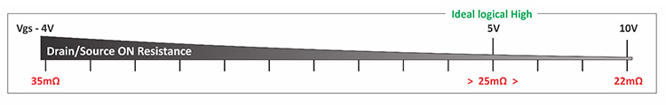

**Parameters to consider when selecting a logic level N-channel MOSFET**
**Gate-Source Threshold Voltage - Vgs(th)(min) and Vgs(th)(max):** Gate voltage at or below the minimum threshold value turns the MOSFET off. Common minimum gate voltages for 5 V logic may fall between 0.5 V and 1 V. Gate voltages above the maximum threshold value turn the MOSFET on. Gate threshold voltages between the minimum and maximum could turn the MOSFET on or off and must be avoided. Notice how the minimum and maximum values roughly coincide with the illegal region in Figure 1.
 ![](https://europe1.discourse-cdn.com/arduino/original/4X/6/b/4/6b4a490761c1747152acbdff2b8edf3f04dd7f28.jpeg "How to Select a MOSFET for Logic Circuits or Gate Design")Figure 1
**Drain-Source ON Resistance - Rds(on):** When turned on, there is resistance between the drain and source that decreases as the gate-source voltage or Vgs increases. Choose a MOSFET whose lowest Rds(on) values occur at or near the ideal logic high voltage value and do not decrease substantially with higher Vgs values. See Figure 2.
 ![](https://europe1.discourse-cdn.com/arduino/original/4X/8/3/5/835aa212fb4be8f8fcae12fa24c25d51bda8107d.jpeg "How to Select a MOSFET for Logic Circuits or Gate Design")Figure 2
_**Example: According to its datasheet, an [Infineon](https://www.digikey.com.br/pt/supplier-centers/infineon-technologies) [IRLZ44](https://www.digikey.com.br/pt/products/filter/transistors-fets-mosfets-single/278?s=N4IgTCBcDaIJICUAyAtALGkBdAvkA) MOSFET has 25 mOhms of drain-source resistance at 5 V, 35 mOhms at 4 V and 22 mOhms at 10 V. At 5 V, its Rds(on) value is only 3 mOhms higher than the value at 10 V but is 10 mOhms lower than the Rds(on) value at 4 V making it a good choice with respect to Rds(on).**_
![](https://europe1.discourse-cdn.com/arduino/original/4X/e/5/e/e5ef127c7f1e1a50824bef1bb47ef4ed6ac8b01c.jpeg "How to Select a MOSFET for Logic Circuits or Gate Design")Figure 3
**Input Capacitance - Ciss:** The combination of the gate, oxide layer, and the body connection of a MOSFET act as a small capacitor that begins charging when voltage is present at the gate. It takes time to charge which results in an ON-state delay. Choose a MOSFET with the lowest input capacitance possible to avoid long delays and to minimize in-rush current which can be very high initially but lessens as the capacitor charges. Ideally, the ON-state delay is extremely short but may create enough surge to damage an I/O pin that has limited current sourcing capacity.
A current limiting resistor between the pin and gate prevents excessive I/O pin current draw.
When using a MOSFET connected directly to a microcontroller output pin, the MOSFET gate should be pulled either high or low as needed using an external resistor to prevent floating gate logic and unwanted output from the MOSFET during MCU startups and resets.
The above parameters are a basic start to selecting a MOSFET for logic circuits or gate designs that may be fine-tuned with additional consideration for heat dissipation and other performance parameters. Don’t be afraid to give MOSFETs a try in your next project design.
Ref: [How to Select a MOSFET | DigiKey](https://www.digikey.com.br/pt/blog/how-to-select-a-mosfet-for-logic-circuits-or-gate-design?utm_adgroup=&utm_source=google&utm_medium=cpc&utm_campaign=EN_Pmax_Products&utm_term=&utm_content=&utm_id=go_cmp-19193358408_adg-_ad-__dev-c_ext-_prd-_sig-Cj0KCQiAjMKqBhCgARIsAPDgWlxmezVU3ngo0kHGHzqE8UDRm5wx4QExOMoM6X1MvI85JYkb74BZjIsaAi24EALw_wcB&gclid=Cj0KCQiAjMKqBhCgARIsAPDgWlxmezVU3ngo0kHGHzqE8UDRm5wx4QExOMoM6X1MvI85JYkb74BZjIsaAi24EALw_wcB)

The IRF520 has an Rds(on) specified for a Vgs of 10V only. So it may or may not work with 5V.
If Temu is claiming they all work at 5V, then you have been mislead.

> [@atmoskidd](#):
> Is there something about the module that makes the IRF520N work at 5V?
No. It's only useful to switch small currents up to a few hundred mA at most from a 5V signal. And that's already stretching it.
The IRF520 is an ancient model and it's a very unfortunate choice in this application.
