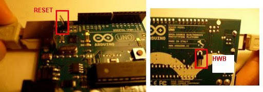

Hardware:
There are two modifications to do:
Solder 2 jumpers: one on the HWB line and one between pin 5 & 6 on ISP1 for RESET
How to put the Uno on DFU mode:
4. put the 8U2 into USB DFU mode:
4.a. assert and hold the 8U2's RESET line
4.b. assert and hold the 8U2's HWB line
4.c. release the 8U2's RESET line
4.d. release the 8U2's HWB line
The device became USB DFU
