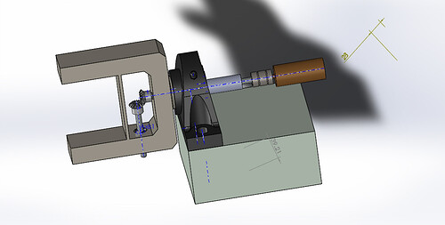

Thanks for the suggestion. I was thinking of something on that line. Please see the drawing. Motor is on the center. I dont think the belt and pulley will slip. The spinning speed not exceed 500rpm actually.
Hollow shaft sounds like a great idea and adding what Morgan said about using a Slipring for the DC motor seems great.
Let me know how this looks.
Looks fairly good, but I would move the smaller motor to the other end of the main shaft and fit its shaft inside the main one. That way, it can be fixed in place and no slip rings will be needed.
I didnt quite get that. I understand that your suggestion will keep the small motor stationary. But how will the smaller motors shaft drive the angular gear drive, might need another coupling shaft.

A long shaft through the main shaft and concentric with it, to drive the bevel gear that you've shown attached to the motor on your diagram. The shaft can be directly coupled to the now moved motor. You'll either need that inner shaft to be a snug fit inside the main shaft (like a sleeve bearing) or fit bearings (between it and the inside of the main shaft) where it enters and leaves the main shaft. All depends on the materials and sizes you're using for the shafts and your preferences. A thin inner shaft in bearings at each end may vibrate in the middle like a piano string. It won't in a sleeve bearing or if it is wider.

I sort of designed the entire set up and was trying to see what difference it is going to make by keeping the shaft on the other end. The power transmitted from the motor is being delivered in more than 4 stages.
I was wondering if it would be much simpler if the motor is placed right at the Yoke junction like this, where the motor is hidden inside the cylindrical area.
Also we might need a slipring at the end of the shaft in either case, so that the motor terminal ends dont keep spinning
