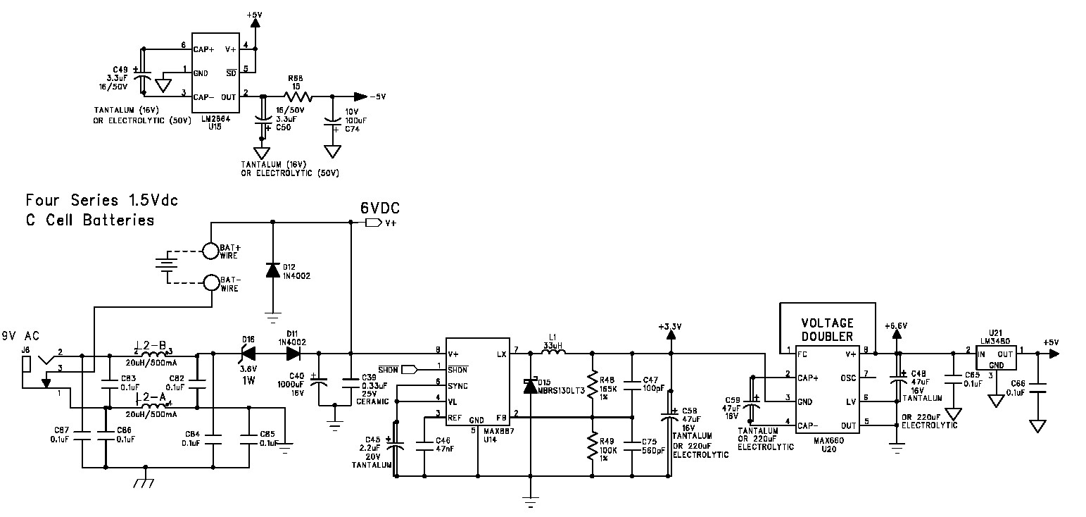

the audio device has a few voltage regulators.
(schematic attached)
but officially it takes either
9V AC
or
6 V DC (four type C batteries)
do you think I could plug in my 7,4 V battery instead of the four type C batteries and rely solely on the already built in voltage regulator? (it is already suppose to take 9V AC anyway, isn't it?)
The MAX887 tolerates up to 11V on its inputs.

The Attiny85 operates at 2.7-5.5V, so the 3.3V from the MAX887 should be usable.
