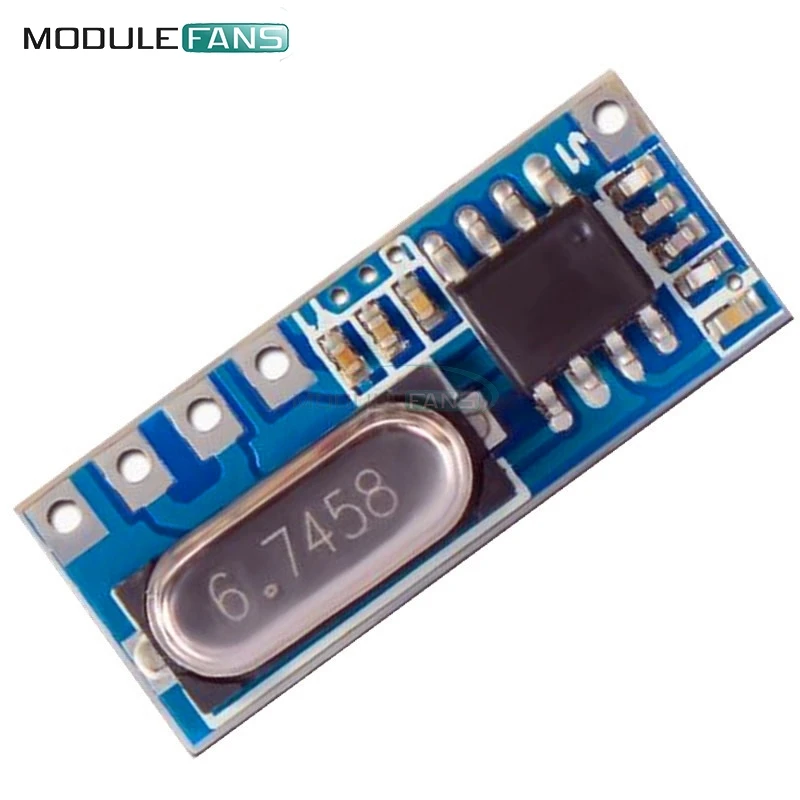

Thanks for the checking my sketch cattledog, I did some more tests like you suggested and here are my observations. Also I found out the model of my receiver module, it's called "LR45B".
If you switch receivers between the nano and the uno, does the problem follow the receiver?
I tried switching the Arduino boards and Yes the problem follows the receiver module. Maybe the library is not meant for this type of module?
I also tried another superheterodyne module called RXB12 and the results were the same as LR45B. When my Generic 433MHz Rx module reads 51, LR45B and RXB12 reads 40. So both superheterodyne modules are reading the same value.
Update: Oops my bad, The reading was correct for the superheterodyne module when connected to the first arduino nano. what could possibly be the problem??

Update: Tried it a new nano and it works fine printing the correct value. Looks like something was wrong with the uno. I couldn't figure out what exactly was wrong with the uno so it's going to the trash can.
Problem solved. Thanks for the suppport @ cattledog.
